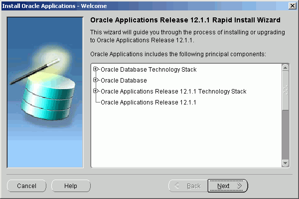

Start the Rapid Install wizard
Start the wizard by entering the command rapidwiz at the command prompt. The Welcome screen appears.
Welcome Screen
This screen lists the components that are included in, or supported by, this release of Oracle E-Business Suite. Use the scroll bar to bring all the components into view.
For an upgrade, Rapid Install creates an Oracle 11gR1 Database Oracle Home without a database. You can use this Oracle Home to upgrade or migrate your existing database to Oracle 11gR1.
This screen is for information only. No action is required. Click Next to continue.

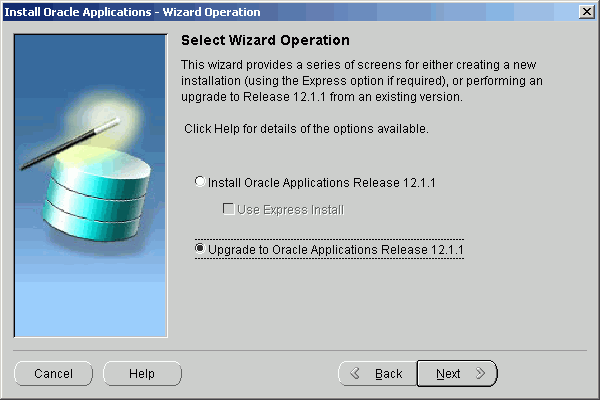

Select a wizard operation
Use the Select Wizard Operation screen to indicate the action you want Rapid Install to perform. You begin both new installations and upgrades from this screen. Based on the action you choose, the Rapid Install wizard continues with the appropriate screen flow.
The available actions are as follows:
Install Oracle Applications Release 12.1.1
This action sets up a new, fully configured system, with either a fresh database or a Vision Demo database. The configuration is derived from the system-specific configuration parameters you enter in the Rapid Install wizard and save in the configuration file (conf_<SID>.txt).
Note: The steps in Standard Installations describe a new installation.
Express Configuration
This action sets up a fully configured, single-user, single machine system with either a fresh database or Vision Demo database. You supply a few basic parameters, such as database type and name, top-level install directory, and increments for port settings. The remaining directories and mount points are supplied by Rapid Install using default values.
Note: The steps in Setting Up an Express Installation in Standard Installations describe this option.
Upgrade to Oracle Applications Release 12.1.1
Choose this option to indicate that you are upgrading your Oracle E-Business Suite products to the current version of Oracle E-Business Suite. The wizard screen flow presents two paths: one that lays down the file system and installs the new technology stack, and one that configures servers and starts services.
In subsequent steps, you will enter information in the wizard for upgrading a system. Select Upgrade to Oracle Applications Release 12. Then click Next to continue.

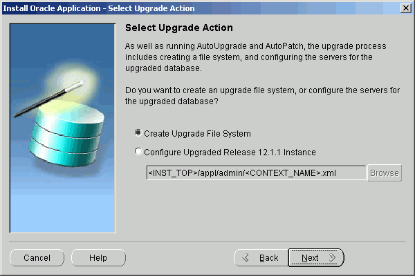

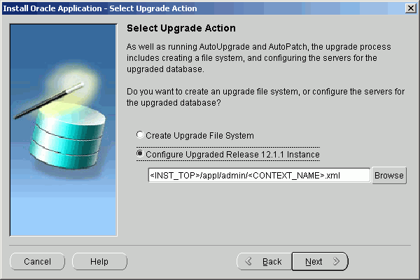

Choose upgrade option
On the Select Upgrade Action screen, you can choose to create an upgrade file system for your upgraded system, or configure the upgraded instance.
The actions associated with an upgrade are performed in separate Rapid Install sessions, as follows:
Create Upgrade File System
You choose this option when prompted to run Rapid Install as a pre-upgrade step in the Oracle E-Business Suite Upgrade Guide. In the screen flow associated with this option, the wizard collects configuration parameters for your system and stores them in the Oracle E-Business Suite database. When you run Rapid Install, AutoConfig uses these values to lay down the file system structure and technology stack components for your configuration. When it runs, it also creates a context file (<CONTEXT_NAME>.xml) that contains all the parameters that describe your system. This context file is created and managed by AutoConfig.
Configure Upgraded Release 12.1.1 Instance
You choose this option when prompted to run Rapid Install as a post-upgrade task in the Oracle E-Business Suite Upgrade Guide. In the associated screen flow, you specify the name of the context file (<CONTEXT_NAME>.xml) that AutoConfig created when you initially ran Rapid Install. This time, AutoConfig uses the values in the context file to configure the servers and start the services.
Choose Create Upgrade File System and click Next

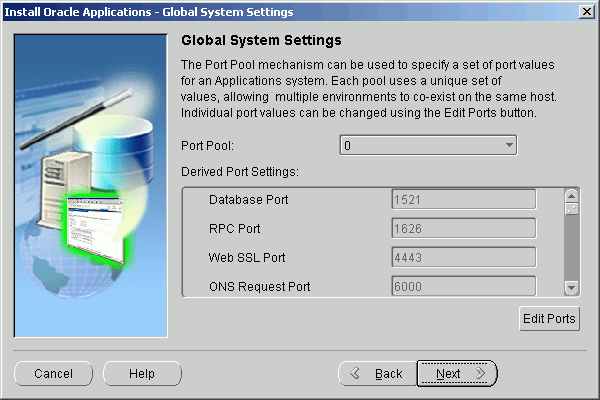

Specify Global System Settings
On the Global System Settings screen, you indicate required port usage for your system, selecting the port pool and (if required) individual port values.
After making your selections, click Next to continue.

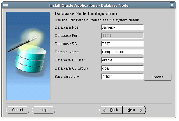

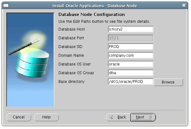

Specify database node configuration
On the Database Node Configuration screen, describe your existing database.
Enter the name that you want Rapid Install to use to identify your existing database in the Database SID field. The name must be alphanumeric, not exceed eight characters in length, not start with a number, and contain no spaces. Rapid Install records this name in the Net Services configuration and in the init<SID>.ora file.
Enter a valid domain name. This value, when combined with a host (machine) name, must produce a fully qualified domain name (FQDN). For example, a host name of apps1 and domain name of company.com make up an FQDN of apps1.company.com
After completing all required details, click Next to continue.

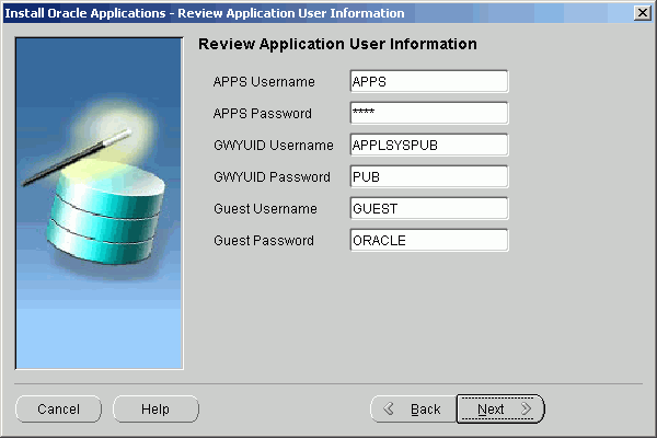

Review username and password information
The Review Application User Information screen lists usernames and the default passwords assigned by the wizard for the Application user.
Important: Record the actual passwords for your existing system before you continue.
As shown on the screenshot, the usernames and their respective default passwords are: APPS Username (APPS), APPS password (APPS), GWYUID username (APPLSYSPUB), GWYUID Password (PUB), Guest username (GUEST), and Guest password (ORACLE).
Complete the text fields to change all the passwords on this screen to match those in your existing system. The wizard stores this information in the configuration file.
Warning: Failing to record this information accurately could compromise the upgrade.

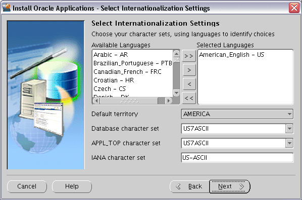

Specify Internationalization settings (conditional)
The Select Internationalization Settings screen displays settings for systems that require NLS functionality.
The languages you select determine the available options for the other NLS-related configuration parameters (such as base language, territory, and character set) that your system requires.
Double-click a language in the Available Languages box to move it into the Selected Languages box or highlight it and click the right arrow (>). Highlight a language in the Selected Languages box and click the left arrow (<) to remove it. To select or deselect all languages in a single action, use the double arrows, >> or <<.
Note: You cannot remove American English from the Selected Languages box.
You may need to perform additional tasks to finish the language installation. See Oracle E-Business Suite NLS Release Notes for details. You can register additional languages any time after the initial installation or upgrade. See Registering Languages in Oracle E-Business Suite System Administrator's Guide - Configuration.
This screen displays Rapid Install defaults, as described in the following paragraphs.
Selected Languages: If you have other active languages in your existing system, you can change the default, and add languages to reflect the existing database character set.
Default Territory: This field is set to AMERICA, and should remain so during the upgrade. Your system administrator can change this value after the upgrade, if necessary.
Database character set and APPL_TOP character set: Defaults to a common character set that is compatible with the active languages indicated on the Select Additional Languages screen. If they are not the character sets in your existing system, select the correct ones from the drop-down list.
IANA character set: The Internet Assigned Numbers Authority character set is the Internet-assigned standard used by the Web server. For more information, see http://www.iana.org/assignments/character-sets.
If necessary, change this value to indicate the one used in your existing system. Click Next to continue.

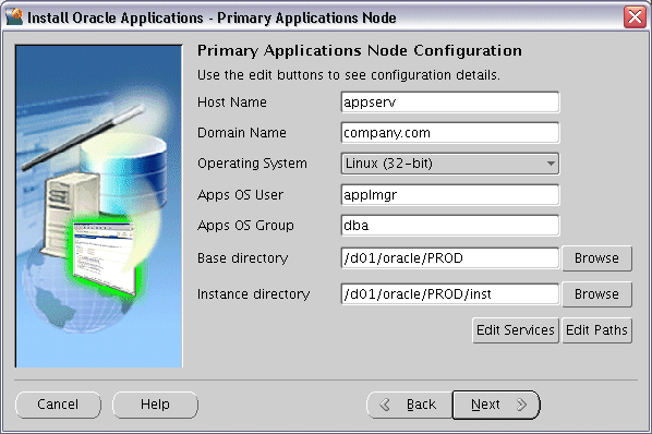

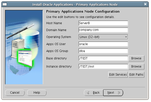

Enter Primary Applications Node information
You have already specified the top-level directory and the mount points for the RDBMS. Now you must specify top-level directory and subdirectories associated with the primary Applications node.
Primary Applications Node Configuration
The default directories use the syntax of the operating system on which you are running Rapid Install. You can either accept the defaults, or enter new values.
Some of the fields are operating system dependent: for example, the UNIX Toolkit directory and Visual Studio directory are specific to Windows. If using a Windows platform, enter the location of the MKS (or Cygwin) tools in the UNIX Toolkit directory field, and the location of the Visual C/C++ executables and DLLs in the Visual Studio directory field. If using a UNIX system, complete the information for the Apps OS User (the account that owns the Applications node file system and technology stack) and Apps OS Group (the group to which the Apps OS User belongs).
The Base directory is the top-level directory that Rapid Install will use to derive the mount points for the Applications node. You can accept the default or enter a new value. Click Browse to navigate to a new path, and double-click the required directory to select it.
The Instance directory (new in Release 12) stores instance-specific files, including runtime generated files, log files, and configuration files. It can be a local directory (for better access speed). It does not have to be in a shared location.

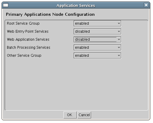

Clicking the Edit Services button enables you to choose which services are enabled on this Applications node. Clicking the Edit Paths button opens a window where you can specify a new value for one or more of the Applications node paths.

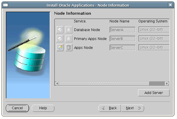

Review global settings

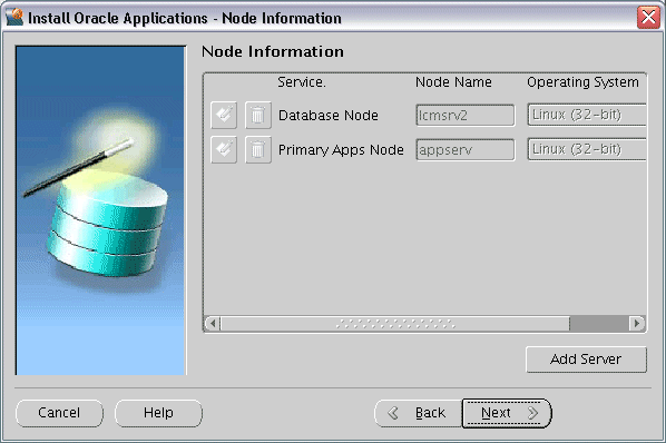

Rapid Install uses the values specified on the Global Settings screen to identify a qualified domain name and to derive port settings that your system will use to connect services and listeners.

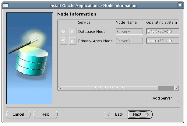

Review Node Information
Click on the Add Server button, supply details of any other Applications nodes you wish to add, and click Next when complete.

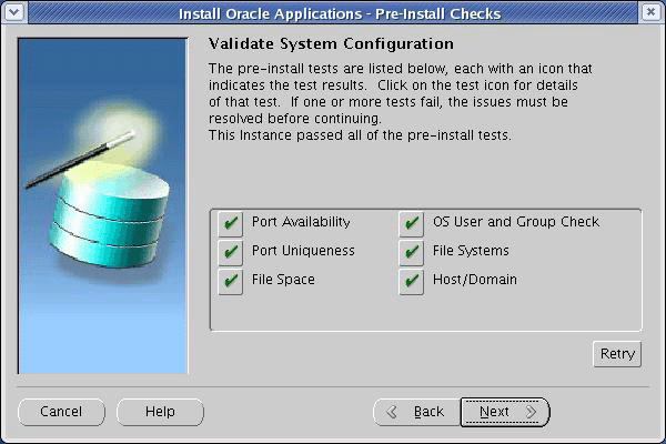

Review pre-install test results
Rapid Install begins to validate the configuration described by your configuration file. It lists the tests performed on the Pre-Install Checks screen and marks each one with an indication of whether it succeeded or failed.
Pre-Install Checks
The parameters that Rapid Install validates include:
The results of each test are labeled using an icon. There are three types:
Check (tick) mark
The test succeeded. Click the mark to obtain details of the test performed.
Exclamation mark (!)
The configuration requires review. Click the ! to obtain information from the system test review. Rapid Install alerts you if you continue without resolving the issues.
An x mark
All issues marked x must be resolved before you continue with the installation. Click the x to see the errors. If you can resolve an issue by fixing the values provided on the settings screen(s), click Back until you reach the appropriate screen, and re-enter the values. Some tests must be resolved in the operating system. In that case, you may have to restart the Rapid Install wizard after the problem has been fixed.
Note: See Restart the Installation in Standard Installations.
When there are no further issues to resolve, click Next to continue.

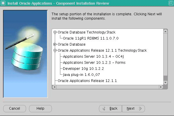

Rapid Install lists the actions it will take during the installation process. The content of the list varies, depending on your installation choices.
Review Components
Click Next to continue. Rapid Install displays another alert screen asking you to verify that you are ready to begin the installation. Click Yes to continue.

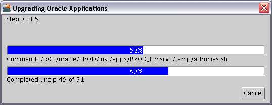

Monitor Installation Progress
Check progress bars
During an installation, Rapid Install displays a main progress bar and an individual progress bar. The main progress bar reports on the completion percentage of the installation as a whole. The individual progress bar reports on the progress of each individual step.
Important: The installation is not complete until all progress bars have disappeared from your screen.

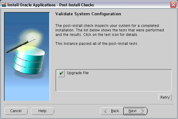

Review post-install checks
When the processing is complete, Rapid Install displays the Post-install Checks screen.
Post-Install Checks
If the test does not succeed, review the errors listed on the screen. Click the Back button to return to the appropriate screens and make corrections as needed. Then click the Retry button.
If there are no errors, click Next. Rapid Install displays a Finish screen that lists the components that it has installed, and describes any steps you need to perform to complete the upgrade. Review the information on this screen, and click Finish to exit Rapid Install.

Enter the required information for Server A:

Click on the Edit Services button to enable the required services for Server B. In this example, you will need to enable Batch Processing Services only.
Specify Services to be Enabled
On the Applications node information screen, add another Applications node by clicking the Add Server button:

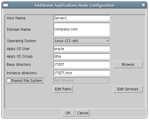

Enter the information for the additional Applications node, Server C:
Specify Additional Applications Node - Initial Screen

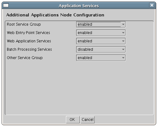

Click on the Edit Services button to enable the required services for Server C. In this example, you will need to enable Root Services, Web Entry Point Services, Web Application Services, and Other Service Group:
Continue the Rapid Install run:

Run Rapid Install on Server B as follows:
rapidwiz -silent -config <configuration file>
For example:
rapidwiz -silent -config /u01/PROD/conf_PROD.txt
Server B's file system will then contain top-level directories for Oracle Application Server 10.1.2.3, Oracle Application Server 10.1.3.4, APPL_TOP, COMMON_TOP, and INST_TOP.
Run Rapidwiz on Server C as follows:
For example:
Server C's file system will then contain top-level directories for Oracle Application Server 10.1.2.3, Oracle Application Server 10.1.3.4, APPL_TOP, COMMON_TOP, and INST_TOP.
To upgrade a two-node system (database node and a single Applications node) you would carry out a similar procedure, omitting Steps 5, 6, 7, and 11.

Configure an Existing Instance
When you ran Rapid Install previously, it created and stored an instance-specific context by replacing system variables you entered on the wizard screens with the specific values you saved in the configuration file (config.txt). In this section, you point Rapid Install to the Applications context file, so that it can use the values there to complete the process of configuring your system.
First, ensure that the database and Net Services listeners are started. Then start Rapid Install as instructed in Start the Rapid Install wizard.
On the Select Wizard Operation screen, choose the Upgrade to Oracle Applications 12.1.1 option to indicate you are performing an upgrade. This displays the Select Upgrade Action screen.
On this screen, select Configure Upgraded Release 12.1.1 Instance to indicate that you want to configure and start the servers for the upgraded database.
Indicate name and location of context file
When you ran Rapid Install previously, it configured your system by replacing system variables you entered on the wizard screens with the specific values you saved in the configuration file (config.txt). It stored this information as an Applications context file named <CONTEXT_NAME>.xml.
Note: See AutoConfig in Oracle E-Business Suite Concepts.
Complete the directory path to point Rapid Install to the Applications context file, <.INST_TOP>/appl/admin/<CONTEXT_NAME>.xml. Enter the path directly in the box, or click Browse and select the path.
