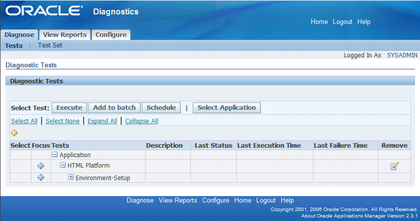

You can select diagnostic tests to execute using the Diagnostics Tests page.
Note: Only tests which you have permissions to execute will be listed in the HGrid table.
Click on the Select Application button to populate the HGrid table with registered applications. To find an application, enter an application name or partial application name with wildcard(s) and click the Go button. Alternatively you can search on "Application Short Name". Multiple application names or short names are allowed, but must be separated by commas.
Each registered test will show a Select check box to be used when selecting a test to execute.
Click on Focus to drill down on an application or group.
Additional details are shown:
The Tests column shows the application name, group name, and related tests that are available to execute.
Descriptions of the tests are given with input parameters, if any.
The Last Status column indicates whether the tests completed successfully or with errors. A check mark represents that the test completed successfully, while a box/square indicates that the test is pending, and an X mark indicates that the test completed with warnings and possible errors.
Last Execution Time shows the date and time when the test was last executed.
Last Failure Time shows the date and time of the last failed execution.
Click on the Execute button to execute one or more tests. If multiple tests are selected and the Execute button is clicked, the action is treated as clicking the Add to batch button
Click on the Add to batch button to execute one or more tests or to create a test set.
To run the test with pre-configured inputs, select the test and click Add to batch. Click on the Test Inputs link and select the pre-configured inputs.
Click on the Schedule button to schedule the execution of a test using concurrent manager scheduling. Only one test can be scheduled at a time.
Click on Select All to select all tests shown for an application.
Click on the Select None to deselect all tests selected for an application.
Click on Expand All to view all tests for the queried application.
Click on Collapse All to view no tests for the queried application.

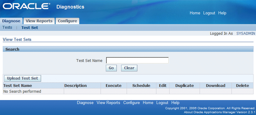

View test sets using this page.
You can search for a test set by entering a specific Test Set Name or by entering part of a Test Set Name with a wild character as prefix or a suffix.
The results region includes the following:
Test Set Name - the user-entered test set name.
Description - the user-entered description of the test set.
Click on the Execute icon to submit a Test Set.
Click on the Schedule icon to schedule a Test Set.
Click on the pencil icon to edit a Test Set.
Click on the Duplicate icon to copy a Test Set.
Click on the Download icon to save a Test Set to a local file system.
Click on the Trash Can icon to delete a Test Set.
Click on the Upload Test Set button to upload a test set from a local file system into the database.
You can upload a test set using this page.
Click on the Browse button to search for the test set in your local file system. Once you select the test set, you can upload it to the Diagnostics database so it will be available for execution.
Click on the Upload button to save the test set from a local file system into the database
Click on the Cancel button to return to View Test Set page.

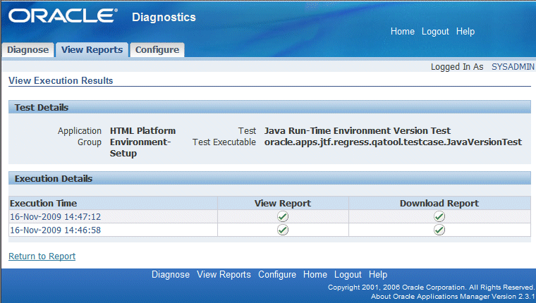

View test results using this page.
View Execution Results shows the Request Name.
The Test Details region includes:
Application - the application name associated with the test
Test - the name of the test
Group - the name of the group the test is associated with
Test Executable - the name of the test executable
The Request Details region includes:
Submitted On - the date and time the test was submitted.
Status - the current status of test (Running, Completed).
Last Refreshed On - the date and time when the page was refreshed for the last time.
Elapsed Time - how long the test took.
Execution Details region includes:
Execution Time - the date and time the test was executed.
View Report - shows a check mark if the report is available to view, shows a clock if the test is still executing, or shows an 'X' meaning the test completed with warnings and/or errors. Once the report is available to view, you can click on the check or 'X' icon to get details.
Download Report - shows a check mark if the report is available to download, shows a clock if the test is still being formatted for download, or shows an 'X' meaning no downloadable report available. Once the report is available to download, you can click on the check icon to download it.
The Execution Details region includes test inputs with the exception of confidential inputs.
The Return to Select Test button - takes you back to the tests selection page
The Refresh button is used to refresh the page with the latest status of the execution and report generation.

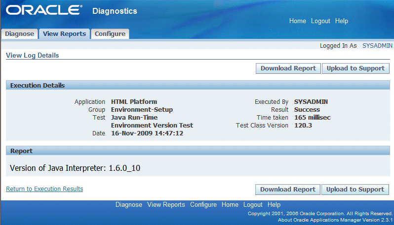

You can view the report of a specific execution of a test using this page.
The Execution Details region includes:
Application - the application name associated with the test.
Executed by - the name of user who submitted the test.
Group - the name of the group with which the test is associated.
Result - the result of the diagnostic test, that is, success or failure.
Test - the name of the test.
Time Taken - the total elapsed time for the test execution.
Date - the date and time the test was executed.
Test Class Version - the version of the test.
The Inputs region lists all of the input parameters used to execute the test.
The Report region shows all details of the report.
The Return to Execution Results link returns you back to the View Reports page.
Use the Download Report button to download the report to your local PC. If the report generation is still in progress, a Refresh button appears instead. Refresh the page to check the report generation status.
Use the Upload to Support button to upload the report to Oracle Support. You will be prompted to enter a My Oracle Support Service Request Number and to upload the downloaded report from your PC.

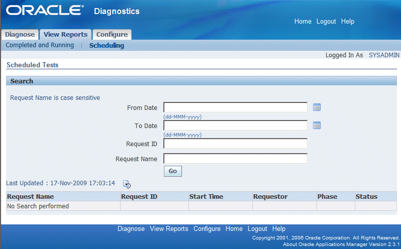

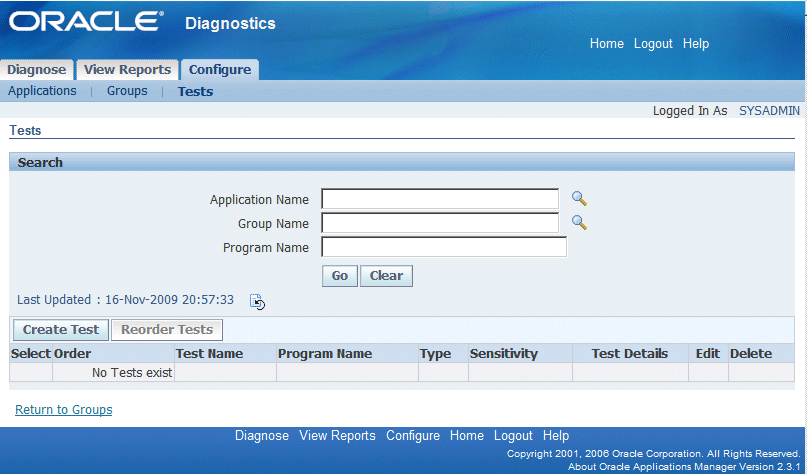

You can view the Scheduled Tests using this page.
You can search for a test using the Request Name (with wildcard support with "%"), the Request ID, or the date submitted.
The Diagnostics Concurrent Request region includes the following information.
The Request Name shows all requests that have been executed, running, or scheduled. Information shown includes the request name, the requestor, test name, date & time, and request ID. Clicking on the request name takes you to the View Report screen.
The Request ID is the concurrent request ID assigned to the scheduled test. Clicking on the request ID link takes you to a concurrent manager request summary screen which allows you to review the concurrent processing log file.
In addition, the following information is shown:
Start Time shows the date and time a test is scheduled to start.
Requestor shows the user ID of the person who scheduled the test.
Phase shows the concurrent manager phase (pending, running, and so on).
Status shows the concurrent manager status (scheduled, normal, and so on).

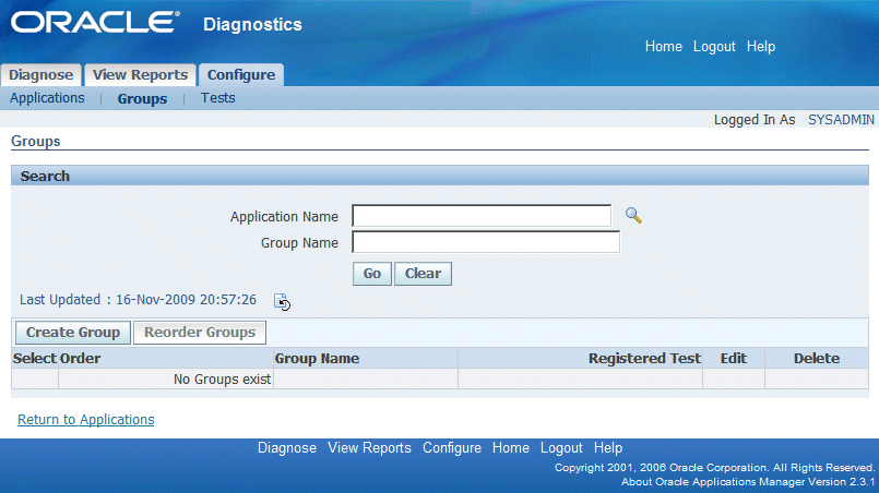

You can view all the groups registered under an application using this page.
If you have come to this page from the View Registered Applications page, then the selected application will be shown in the LOV field.
Alternatively, you can come directly to this page through the Groups subtab.
A search can be conducted using the application name and group name. If the group name is left blank all the groups under the application will be displayed.
Details shown include the number of registered test under each group.
Click on the Update icon to update the details of the group. This action is restricted to only those users who have configuration privileges.
Click on the Delete icon to delete the group. This action is restricted to only those users who have configuration privileges
Click on the Reorder button to change the order in which the groups are organized under the parent application. This action is restricted to only those users who have configuration privileges.
Click on the Create Group button to create a new group. This action is restricted to only those users who have configuration privileges.
Click on the View Tests button to view all the tests registered under this group.
Note: Seeded groups cannot be edited or deleted by end users.

You can view all the tests registered under a group.
If you have navigated to this page from the View Groups page, then the selected application and group will be shown in the LOV field.
You can directly navigate to this page through the Tests subtab.
A search can be conducted using the Application name and Group name. If the program name field is left blank, then all the program names under the group will be displayed.
Click on the View Input values button to view current input values and to add additional rows. This button will be enabled only if the user has permission to execute the test.
Click on the Create Test button to create a new test. This action is restricted to only those users who have configuration privileges.
Click on the Reorder Tests button to change the order in which the tests are organized under the group. This action is restricted to only those users who have configuration privileges.

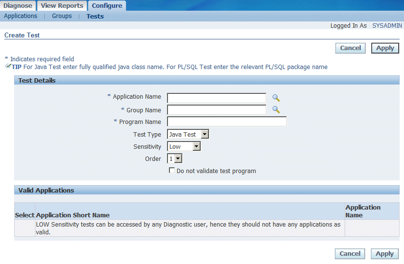

Create diagnostic tests using this page.
Select the Application Name using the LOV.
You can change the Group Name using the LOV.
Enter a Program Name:
For a Java Test by entering the fully-qualified Java class name.
For a PL/SQL Test, the package must be in the APPS schema.
For an XML Test, the XML file must reside in the JAVA_TOP in the corresponding product folder. Example:
oracle/apps/fnd/oam/diagnostics/tests/sampleXMLTest.xml
Note: This placement is similar to that for registering a Java test except the forward slash (/) must be used as the separator.
Select the Test Type that matches the corresponding program name. Valid test types are Java, PL/SQL, XML, or Declarative.
You can optionally check the Do Not Validate test program box. If checked, the framework will not try to validate the executable; otherwise the framework will try to load the test and see if it is adhering to diagnostics standards.
Select the Sensitivity Type of low, medium, or high depending on the sensitivity of a test.
You can accept the default order test sequence number or select a previously-used order test sequence number.
Click on the Cancel button to cancel your changes.
Click on the Apply button to save your changes.
