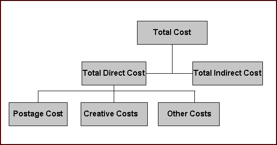

The metric hierarchy dictates how objects relate to each other and how their associated metric values will rollup within the hierarchy. Ultimately, the metric hierarchy dictates how metric values will be totalled across marketing objects.
Within a single marketing object, metrics of similar categories (cost, revenue, response, and so on) are organized into summary hierarchies. For example, within a direct mail campaign activity, cost-category metrics can be related hierarchically as shown in the following figure:
Summary Hierarchy
In this example, Postage Cost, Creative Costs, and Other Costs are summarized to Total Direct Cost. These lower level costs are added to Total Indirect Cost (for example, overhead expenses) to obtain Total Cost for the Campaign Activity.
