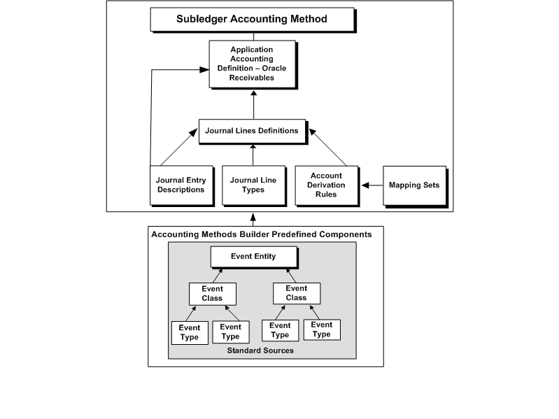

The relationship between the various AMB components are displayed in the diagram below and is described in the succeeding text.
Accounting Methods Builder Components
The above diagram shows how the AMB predefined components, standard sources, event entities, event classes, and event types, can be used to create journal entry descriptions, journal line types, account derivation rules, and mapping sets. The mapping sets are used in the setup of account derivation rules. The journal line types, account derivation rules, and journal entry descriptions are assigned to journal lines definitions. The journal lines definitions and optional journal entry descriptions for the journal headers, are assigned at the application accounting definition level. Application accounting definitions are grouped in a subledger accounting method.
Oracle Applications development provides startup application accounting definitions and at least one subledger accounting method for all products using Oracle Subledger Accounting. If users do not have any special accounting requirements, these startup definitions may meet their needs and the only required setup step is to assign subledger accounting methods to the ledger.
If users have specific accounting requirements that are not met by the startup definitions, they can copy and modify the seeded definitions or create new definitions.
The Components for Building Accounting Definitions figure below shows the components in the Accounting Methods Builder process for building accounting definitions and is described in the succeeding text.
The components in the figure above are used by the Subledger Accounting program to create subledger journal entries. Before creating or modifying any components or definitions, check whether the seeded application accounting definitions meet your requirements. In the event that more detail is required than that provided by the default definitions, modify them or create new ones.
Since the flexibility for creating accounting definitions is dependent on source availability, Oracle subledgers provide standard sources. Create custom sources for use in accounting definitions.

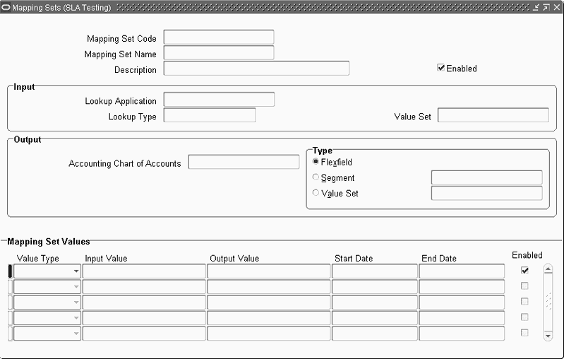

Use mapping sets in the account derivation rules setup. By mapping input values to different outputs, mapping sets provide flexibility in the creation of account derivation rules. The use of mapping sets is optional.
See: Mapping Sets

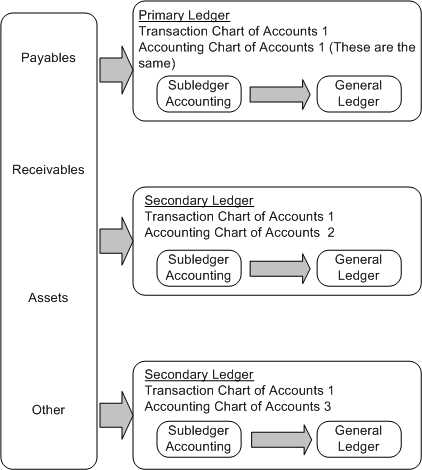

Both the transaction chart of accounts and the accounting chart of accounts are used extensively in the AMB and are quite distinct. These fields appear in several setup windows.
The transaction chart of accounts is the chart of accounts for the primary ledger and is referenced when users enter Accounting Flexfields for their transactions. This chart of accounts is employed when users enter and maintain the data required to support the daily operations of a company.
For example, a receivables invoice is recorded in the system. The item, tax, freight, and other Accounting Flexfields that users view and enter for the invoice contain the structure and values from the transaction chart of accounts. Similarly, recording the receipt of goods and invoices as well as the issue of payments are all done in the context of a transaction chart of accounts structure.
Values for Accounting Flexfield sources stored in the transaction objects are taken from the transaction chart of accounts. Use these source values in the AMB account derivation rules and conditions.
Use the accounting chart of accounts to create the Accounting Flexfields for subledger journal entries. It is taken from the ledger for which the journal entries are created.
Account derivation rules derive accounts for a specific accounting chart of accounts. The creation of all journal entries by Subledger Accounting is therefore done in the context of the accounting chart of accounts.
Note: The transaction and accounting charts of accounts are always the same for the primary ledger. They can be different in cases where users create secondary multiple representations.
Assign each subledger accounting method to many ledgers. The combination of a subledger accounting method and ledger is called an accounting representation. The primary ledger reflects the primary accounting representation. In the primary ledger, the transaction and accounting charts of accounts are always the same.
Create multiple accounting representations by using secondary ledgers. Due to regulatory or other requirements, the accounting for these ledgers can be different than the accounting for the primary ledger. Each of these ledgers can have a different subledger accounting method assigned to it and is a secondary accounting representation. Create several secondary representations, each with a different currency, chart of accounts, calendar, and set of accounting definitions. An example of multiple accounting representations is described in the figure below.
Multiple Accounting Representations

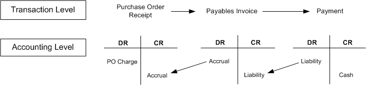

Use business flows to establish a link between the accounting of transactions that are related both within the same application and across applications. With this link, you can preserve key accounting information across related transactions instead of using the same set of rules to derive this information.
The purpose of business flows is:
Preserve General Ledger accounts or segment values across journal entries of related transactions within a business flow
Ensure proper General Ledger balances
A business flow is a series of logically related business transactions and their accounting where the creation of one transaction causes the creation of another transaction which itself can result in another transaction.
For example, when goods are received, an invoice is entered and the invoice is paid. The business flow at the transaction level is:
The receiving transaction is entered to acknowledge the arrival of the goods.
The invoice is entered to acknowledge that the supplier is owed for the goods and therefore references the receipt transaction.
The payment is created to satisfy the amount owed on the invoice and therefore references the invoice.
The business flow at the accounting level is:
The receipt generates an entry to the purchase order charge account.
This entry is offset by an accrual entry representing a future invoice liability.
The invoice reverses this accrual entry and creates the invoice liability, and the accounting for the payment reverses the invoice liability and generates the entry reducing the company's cash account.
The diagram below illustrates this example.
Basic Business Flow Example

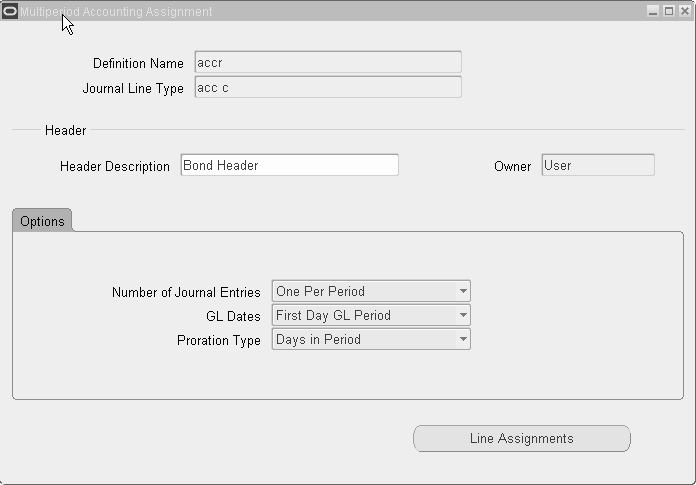

Users can specify whether to apply multiperiod accounting to a journal line type.

Use mapping sets to associate a specific output value for an Accounting Flexfield or Accounting Flexfield segment. Based on the input value, a specific value can be assigned to a single segment or to the entire Accounting Flexfield. Use mapping sets in account derivation rules to build the Accounting Flexfield.
To define a Mapping Set, pairs of values are specified. For each input value, specify a corresponding account segment or Accounting Flexfield output value. One or more related pairs of these input values and segment or Accounting Flexfield output values form a mapping set. Use value sets or lookup types for validating the input values of the mapping set.
For example, it is possible to create a mapping set based on two input values, Yes and No. Apply these input values to determine the balancing segment value of an account: 01 if the input value is Yes and 02 if it is No. Use this mapping set in one of the rules that builds the segment values of an account. The rule compares the value of a source to see if it is Yes or No and determines the segment value accordingly.
As another example, suppose a business has three major regions: East, South, and West. Assume also that the business has a Region Code segment in the Accounting Flexfield. Region names can be input values in applications such as transaction type names and service codes. These input values can be included with other information about the transaction and become part of the source information available to the AMB. Users can create a mapping set that maps region names to the corresponding region code as described in the table below.
| Input Value | Segment Value |
| East | 01 |
| South | 02 |
| West | 03 |
It is possible to restrict a mapping set to a range of dates by entering the start and end dates. The GL date of the potential subledger entry is compared to the effective date range of the mapping set. This determines whether mapping set values should be applied.
Using value sets and lookup types prevents data entry errors when entering input values. If planning to use either value sets or lookup types to validate the input values, they must be defined before setting up mapping sets. If neither a value set nor a lookup type is selected, users can enter any value in the Input Value field.
See: Overview of Values and Value Sets, Oracle Applications Flexfields User Guide
| Field | Description |
| Enabled | If selected, makes the mapping set available for use |
| Type region | Based on this selection, the mapping set is defined for the setup of the entire Accounting Flexfield, an individual segment in the flexfield, or a value set. The Flexfield and Segment options are disabled if the accounting chart of accounts is not specified. The Value Set option is disabled if the accounting chart of accounts is specified. |
| Segment | If selected, enter the segment to be used to assign a value the mapping set. |
| Value Set | If selected, select the value set. |
| Value Type | If the Value Type is Input, then enter an input value. If Input is selected and a value set or lookup type is defined, then the list of values includes all the allowable values defined for the lookup type or value set. Use the value type Default in cases where the source value from the transaction is not equal to any of the input values in the mapping set. If a mapping set is used and the Subledger Accounting program encounters accounting definitions with undefined input values, journal entries cannot be successfully generated unless there is a default. Using the example introduced earlier in this section, if there is a source value equal to Northwest, it would not map to any of the input values. Specify a default value of 04 for any regions not included as input values. This prevents entries from failing validation when the Subledger Accounting program is submitted. |
| Input Value | If the value type Input is selected, enter an input value to be mapped to a corresponding output value. |
| Output Value | For a given input value, enter the corresponding output value. The account derivation rule uses this value to populate either the accounting flexfield or accounting flexfield segment. If the Value Set option in the Type region is selected, the output value is an individual value from the value set entered in the Value Set field of the Type region, and the list of values includes all values from this value set. In the case where a mapping set is defined to populate an individual segment value, the output value is an individual segment value and the list of values includes all values for the segment entered in the Segment field. If the Accounting Flexfield option in the Type region of the Mapping Sets window is selected, then the output value is the entire Accounting Flexfield and the list of values includes all enabled combinations for the accounting chart of accounts. |
| Start Date and End Date | Effective range dates for the mapping set |
| Enabled | If selected, makes the mapping set values available for use. |

Using a mapping set to derive an Accounting Flexfield
Consider a mapping set Vendor Category, which assigns the following accounts based on input vendor category described in the following table.
| Input Value | Output Value |
| Manufacturing | 01-100-2210-0000 |
| Services | 01-200-2210-0000 |
| Consulting | 01-300-2210-0000 |
For the given transaction, assume that the accounting event information includes a Source called Supplier Type. This serves as the Mapping Set Input Source. The account derivation rule is defined to use the mapping set as described in the following table.
| Priority | Value Type | Value | Input Source |
| 1 | Mapping Set | Vendor Category | Supplier Type |
To derive an account, the values of the Mapping Set Input Source specified in a rule are compared with the input values of the mapping set. In this example, Mapping Set Input Source values from the accounting event information include the Supplier Type source values. These are now compared with the Vendor Category input values to determine what the account should be.
Assume that the accounting event data of the transaction to which the account derivation rule is applied has a value for the Source Supplier Type of Manufacturing. The account built by the Subledger Accounting program is derived by applying the account derivation rule to the transaction object data. Using the mapping set defined, if the supplier type is Manufacturing, the account created is 01-100-2210-0000.

Using a source to derive the value of a segment in a different chart of accounts.
In this example, the transaction chart of accounts is not entered. Once again, a segment rule is set up to derive the cost center segment. Assume that the charts of accounts are given as described in the following table.
| Chart of Accounts | Name | Structure |
| Transaction | (Blank) | (Blank) |
| Accounting | Belgium | Balancing-Cost Center-Natural Account |
The account derivation rule is set up as described in the following table.
| Priority | Value Type | Value | Segment |
| 1 | Source | Distribution Account |
The segment built by the Subledger Accounting program is determined by applying the account derivation rule to the source values. A segment value from the Distribution account cannot be chosen because the transaction chart of accounts is not known but a segment qualifier can be selected. Note that the account is always derived for the accounting chart of accounts.
When the Subledger Accounting program is run, if the transaction chart of accounts is the same as the accounting chart of accounts, then the resulting segment value in the Belgium chart of accounts mirrors the cost center segment value from the Distribution Account in the transaction chart of accounts.
For secondary environments, where the transaction and accounting charts of accounts are different, the segment value is determined by the chart of accounts mapping.
See: Chart of Accounts Mapping
Note that other segment rules must be defined to build the remaining segments of the account.

| Null | Value Set | Mapping Set | All enabled mapping sets with the same value set |

| Not Null | Flexfield | Mapping Set | All enabled mapping sets with the same accounting chart of accounts and whose output type is Flexfield |

| Not Null | Segment | Mapping Set | All enabled mapping sets with the same accounting chart of accounts and whose output type has the same segment as the segment to be derived in the account derivation rule |

If value type Mapping Set is selected, in the Input Source field, select the source name to be compared with the mapping set input value.

You cannot copy the Journal Line Definitions (JLD) across Chart of Accounts as the line assignments are dependent on the Transaction and Accounting Chart of Accounts. For example, two Journal Line Types (Test Item Expense and Test Item Liability) are created with both the Transaction and Accounting Chart of Accounts (COA) as Operations Accounting Flex. And, two Account Derivation Rules (Test Item Expense Rule and Test Item Liability Rule) are defined with the same Transaction and Accounting chart of account attached to it.
Now define the journal lines definitions with different Transaction and Accounting chart of account, with Services Accounting Flex, then the above two journal lines definitions and account derivation rules are not available in the Line Assignments or the Account Derivation Rules tab. Therefore, when you define the journal lines definitions (Test Accrual) with the Transaction and Accounting chart of account as same as the above journal lines definition and account derivation rules that is Operations Accounting Flex and assign the two journal lines definitions and account derivation rules respectively.
The same rule applies to the Copy functionality. When you copy the journal lines definitions along with the Line Assignments, you cannot change the Transaction and Accounting chart of accounts because the copied journal line definitions and account derivation rules are created with the Transaction and Accounting chart of account of the old Journal Lines Definition. To copy the Journal Lines Definition with different Transaction and Accounting Chart of Account, then copy the Journal Lines Definition without enabling the Copy Line Assignments option. In this case, the application copies only the header information without line assignments and you can enter different Transaction and Accounting Chart of Accounts such as Services Accounting Flex.
Multiperiod accounting enables users to create accounting for a single accounting event for more than one GL period. The functionality is primarily used to recognize revenue or a prepaid expense or revenue across multiple GL periods.
The figure below is described in Multiperiod Accounting Process Steps.
Multiperiod Accounting Process Flow
The multiperiod accounting process includes the following steps:
In the Journal Line Accounting Attributes Assignments window, assign sources for the following accounting attributes:
Multiperiod: Specifies whether a journal line type is eligible for multiperiod accounting
Multiperiod Start Date: Date to begin multiperiod accounting
Multiperiod End Date: Date to end multiperiod accounting
In the Journal Line Types window, define the journal line types to be used for multiperiod accounting by setting the multiperiod option.
See: To Define Journal Line Types
In the Journal Lines Definitions window, complete the following:
Assign the accrual journal line type
Navigate to the Multiperiod Accounting window to define the multiperiod options
In the Multiperiod Accounting window, users define the multiperiod options.
In the Line Assignments window, define the multiperiod line assignments as follows:
Update the line description for the accrual journal entry line type, which defaults from the Journal Lines Definitions window
Assign the recognition journal line types
Assign account derivation rules
Create transactions in subledger applications.
For example, a company may receive a Payables invoice in January for the cost of services for a whole year. However, the company must recognize the expense during the period the expense is incurred. The company enters the originating invoice in Payables to record its receipt.
Submit the Create Accounting program to create the originating journal entry as well as the multiperiod entries.
Periodically, submit the Complete Multiperiod Accounting program to complete incomplete recognition journal entries as their periods become open.
Once the multiperiod journal entries are processed, view the multiperiod journal entries in the inquiry pages for subledger journal entry headers, subledger journal entry lines, and accounting events.
A company must prepay rent for the year. $1,200,000.00 must be paid on December 31, 2005. However, the company needs to recognize the expense over a twelve month period as shown in the table below.
| Total Expense | / | Number of Months | = | Amount Recognized Each Month |
| $1,200,000.00 | / | 12 | = | $100,000.00 |
Assume that the multiperiod accounting duration is from 1-Jan-06 to 31-Dec-06 and that the multiperiod accounting options are as follows:
Number of journal entries: one per period
GL Date: first day of the GL period
Proration method: 360 days
The table below describes the schedule to expense $100,000.00 each month over the next twelve months.

Define the following:
In the Line Assignments region of the Journal Lines Definitions window, select the accrual journal line type which will create the originating entry and click Multiperiod Accounting.
The Definition Name and Journal Line Type fields default from the Journal Lines Definitions window.
Enter data as described in the table below.
| Header Description | Description for the header of recognition entries |
| Number of Journal Entries | Number of multiperiod journal entries to be created. Options are:
| GL Dates | Specifies when the multiperiod journal entries are created in the GL period
Note: If a transaction calendar is assigned to the ledger, Subledger Accounting uses this calendar to ensure that the multiperiod accounting journal entries fall on business days. Options are:
| Proration Type | Specifies how the recognition amount per period should be calculated. Options are:
Click Line Assignments.
The Definition Name, Owner, accrual Journal Line Type, and Line Description fields default from the Journal Lines Definitions window.
The first accrual journal line creates a mirror image of the original accrual line, reversing the impact of the original journal entry to the same General Ledger account. Users cannot change this journal line type or the account derivation rules for it.
The Inherit check box for the description defaults from the Inherit check box in the Journal Lines Definitions window for the accrual journal line type. If selected, users can deselect the check box and assign a new description.

Use accrual reversal to define how and when accrual reversals are automatically performed. You can:
Indicate that an accounting event is eligible for accrual reversal
Schedule the reversal of accrual journal entries generated by the Subledger Accounting program
The diagram below shows the accrual reversal process and is described in the Accrual Reversal Process Steps.
Assign the Accrual Reversal GL Date accounting attribute at the event class level in the Accounting Attribute Assignments window.
Use this attribute to schedule the automatic reversal of a journal entry at the time it is created. Assign any standard date source or one of the following system sources to the accrual reversal GL date accounting attribute:
Next Day: The GL date of the accrual reversal will be the next day following the GL date of the accrual entry. If there is a transaction calendar assigned to the ledger, this will be the next business day.
First Day Next GL Period: The GL date of the accrual reversal entry will be the first day of the following period. If there is a transaction calendar assigned to the ledger, this will be the first business day.
Last Day Next GL Period: The GL date of the accrual reversal entry will be the last day of the following period. If there is a transaction calendar assigned to the ledger, this will be the last business day.
Note: Users can override the accrual reversal GL date accounting attribute values on the journal entry header in the Application Accounting Definitions window.

Use application accounting definitions to assign journal lines definitions, supporting references, and header descriptions to event classes and event types.
Storing the accounting definitions validation status at the event class and event level enables you to generate subledger journal entries for certain event classes or event types even if the accounting definitions for other event classes or event types are invalid.
Each event class and event type assignment consists of a header assignment and one or more journal lines definition assignments. A header assignment includes the following:
source assignments for the GL date and Accrual Reversal GL date, if enabled for the event class
a journal entry description (optional)
one or more supporting references (optional)
You can assign multiple journal lines definitions to an event class or event type. Subledger Accounting generates a single journal entry per accounting event and ledger using the line assignments from all the journal lines definitions assigned to the event class or event type. The following can be assigned to a journal lines definition:
Journal entry description
Journal line type
Supporting references
Sources are used by all of the above components.
The figure below shows the relationship of the components to an application accounting definition as described in the above text.
Application accounting definitions enable you to meet the subledger accounting requirement of multiple accounting representations. While one application accounting definition can generate subledger journal entries that are compliant with one particular set of accounting requirements, another definition can be defined to meet a completely different set of accounting requirements.
For example, use a complete set of US GAAP accounting definitions for Payables as an application accounting definition for the ledger US applications. Use a complete set of French GAAP accounting definitions for Payables can be used for the ledger French Operations. These two sets of definitions have differences based on the setup of the various components that make up their application accounting definitions.
Seeded application accounting definitions are provided for all Oracle subledgers. If specific requirements are not met by startup accounting definitions, users can copy and modify the seeded definitions and their assignments.
