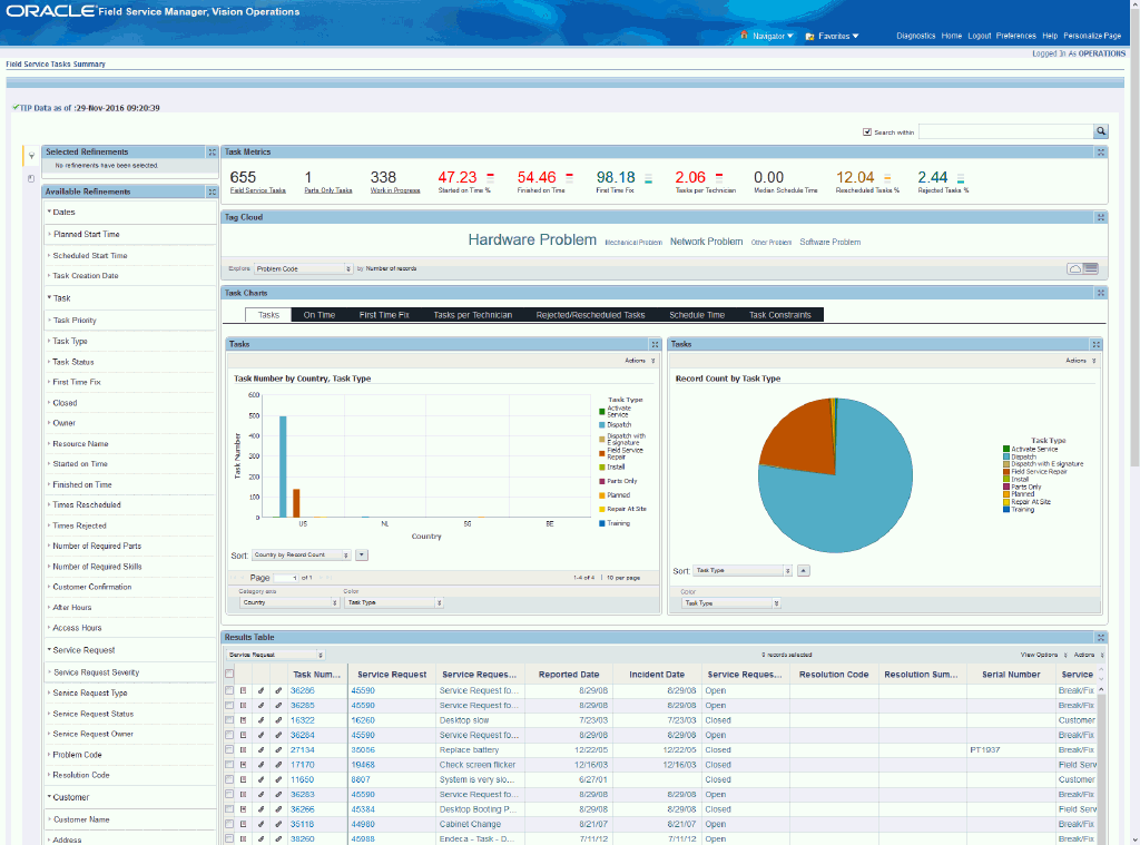

You can use the Field Service Tasks Summary page to view Key Performance Indicators (KPIs) and Metrics for measuring the efficiency of field operations. You can drill down into Field Service Tasks and Technician information using guided navigation, tag cloud, charts, and a results table that displays attributes and various dimensions. You can also export results table data to an Excel spreadsheet.
The following is a display of the Field Service Tasks Summary page.
From the Field Service Manager responsibility, navigate to the Field Service Tasks Summary page:
(N) Field Service Manager > Field Service Tasks Summary
Within the Field Service Tasks Summary page, you can view and analyze field performance data using display tools that include metrics, charts, graphs, and tables. The following describes the Endeca Field Service Tasks Summary page regions and components:

Task
Service Request
Customer
Product
| Task Metrics (summarization bar) Note: The Metric Components are color coded to highlight warnings and health: - Red: Critical warning state - Yellow: Warning - Grey: Normal - Green: Good |
| Tasks Constraints Metrics |
| Problem Code Tag Cloud | Top Ten Problem Codes Tag Cloud Component
Note: The Problem Code tag cloud component displays the top ten problem codes by frequency of occurrence. |
| Tasks Charts (tabbed component container) Tasks (tab) |
Tasks (bar chart)
Tasks (pie chart)
| Tasks Charts (tabbed component container) On Time (tab) |
On Time (bar chart)
On Time, Effort, Duration (trend chart)
| Tasks Charts (tabbed component container) First Time Fix (tab) |
First Time Fix (bar chart)
First Time Fix (trend chart)
| Tasks Charts (tabbed component container) Tasks per Technician (tab) |
Tasks per Technician (bar chart)
Tasks per Technician (trend chart)
| Tasks Charts (tabbed component container) Rejected/Rescheduled Tasks (tab) |
Rejected/Rescheduled Tasks (bar chart)
Rejected/Rescheduled Tasks (pie chart)
| Tasks Charts (tabbed component container) Schedule Time (tab) |
Schedule Time (bar chart)
Schedule Time (trend chart)
| Tasks Charts (tabbed component container) Task Constraints (tab) |
Task Constraints (bar chart)
Task Constraints (trend chart)
| Results Table | Column Sets:

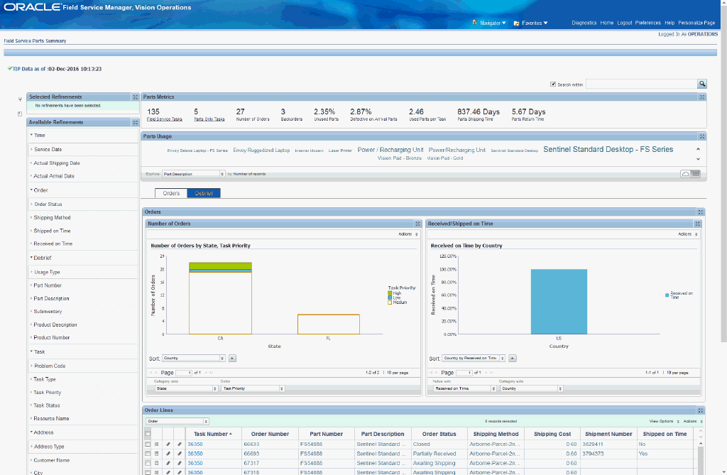

You can use the Field Service Parts Summary page to view Key Performance Indicators (KPIs) and Metrics for spare parts usage, parts orders and back orders pending, and areas of concern. This information is vital for decision making to further improve the operational efficiency of warehouse and service supply chain operations. You can drill down into parts orders, backorders, and debrief information using guided navigation, tag cloud, charts, and a results table that displays attributes and various dimensions. You can also export results table data to an Excel spreadsheet.
The following is a display of the Field Service Parts Summary page.
From the Field Service Manager responsibility, navigate to the Field Service Parts Summary page:
(N) Field Service Manager > Field Service Parts Summary
Within the Field Service Parts Summary page, you can view and analyze the efficiency of Spares Supply Chain and Logistics Operations, based on the analysis of data related to Spare Parts Consumption, Parts Orders, Backorders, Unused Parts, Parts Dead on Arrival (DOA), and Parts utilization per Task using display tools that include metrics, charts, graphs, and tables. The following describes the Endeca Field Service Parts Summary page regions and components:

Order
Debrief
Task
Address
Service Request
| Parts Metrics (summarization bar) Note: The Metric Components are color coded to highlight warnings and health: - Red: Critical warning state - Yellow: Warning - Grey: Normal - Green: Good |
Parts Metrics
| Parts Usage (tag cloud) | Top Ten Parts Tag Cloud Component
Note: The Parts Usage tag cloud component displays the top ten parts by frequency of occurrence. The Tag Cloud is dynamically rendered based on distinct Part Names associated with all Field Service Tasks in the system. Tag cloud can be used to filter the displayed records based on the tag clicked by the user. |
| Charts (tabbed component container) Orders (tab) |
Order Number Count (bar chart)
Received and Shipped on Time (bar chart)
| Charts (tabbed component container) Debrief (tab) |
Chart
Chart
| Order Lines (results table) | Column Sets:
