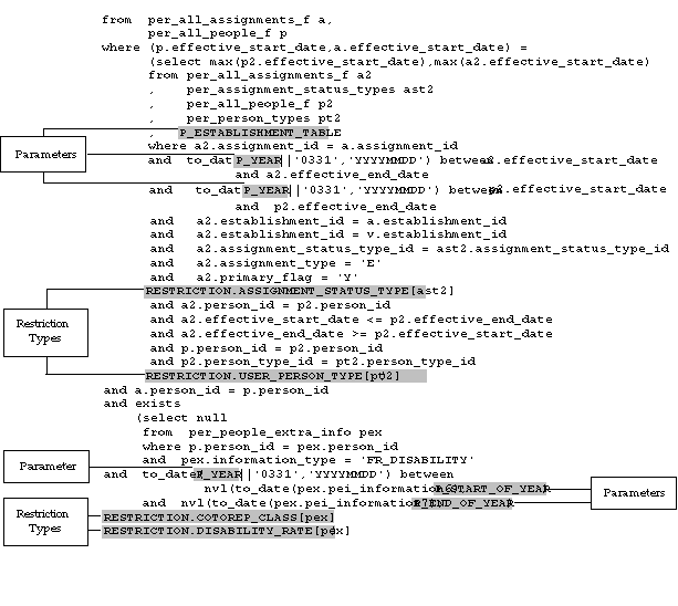

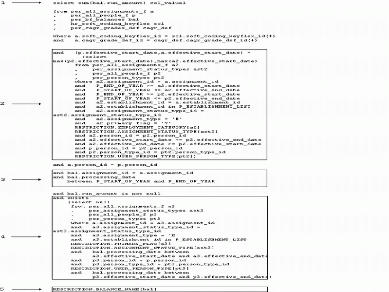

Calculations that are run by the Bilan Social Report process are defined in item types. The columns COUNT_CLAUSE1, COUNT_CLAUSE2 and WHERE_CLAUSE in HR_SUMMARY_ITEM_TYPE are used to build the basic SQL statement which will derive the summary data for a particular item.
The SQL statement is constructed as follows:
FR_00000860select COUNT_CLAUSE1
FR_00000861, COUNT_CLAUSE2
FR_00000862WHERE_CLAUSE
Note: The WHERE_CLAUSE line above, refers to the Where Clause as detailed in Components of the Bilan Social - Where Clause
You can select one or more key types to apply to a particular item type. See later in this section for a description of Key Types. In this case the basic SQL statement is modified to be constructed as follows:
FR_00000863select COUNT_CLAUSE1 col_value1
FR_00000864, COUNT_CLAUSE2 col_value2
FR_00000865, KEY_CLAUSE1 col_KEY_NAME1
FR_00000866, KEY_CLAUSE2 col_KEY_NAME2
FR_00000867WHERE_CLAUSE
FR_00000868group by KEY_CLAUSE1
FR_00000869, KEY_CLAUSE2

In order to offer flexibility within the SQL statements the Where Clause may contain one or more tokens which will be replaced at run time, these fall into two categories, parameters and restriction types, described later in this section.
The following is an example of a Where Clause with the tokens highlighted.
Example of a Where Clause
Parameters are variables that may be embedded in an item type's Where Clause that will be substituted based on the values entered into the Parameter window when submitting the Bilan Social Report process.
The following parameters are currently supported:
P_BUSINESS_GROUP_ID
Replaced with the value of the BUSINESS_GROUP_ID
P_YEAR
Replaced with the value entered into the parameter form
P_START_OF_YEAR
Replaced with to_date (`YEAR0101','YYYYMMDD') where YEAR is the value entered into the P_YEAR parameter
P_END_OF_YEAR
Replaced with to_date (`YEAR1231','YYYYMMDD') where YEAR is the value entered into the P_YEAR parameter
P_COMPANY_ID
Replaced with the ORGANIZATION_ID of the company selected in the parameter form
P_ESTABLISHMENT_ID
Replaced with the ORGANIZATION_ID of the establishment selected in the parameter form
P_ESTABLISHMENT_LIST
Replaced with value in P_ESTABLISHMENT_ID if this is not null otherwise it is replaced with a list of ORGANIZATION_IDs of the form (1001,1002,1003) where the contents are the IDs of those establishments in the selected company.
P_ESTABLISHMENT_TABLE
Replaced with in-line view that retrieves the establishment if not null, or the set of establishments in the selected company. For example,
FR_00001145(select 1001 establishment_id from dual union
FR_00001146select 1002 establishment_id from dual) v
Restrictions take the form:
RESTRICTION.RESTRICTION_NAME[TABLE_ALIAS]
These are replaced when the Bilan Social Report process is run by referring to the restriction types defined in the Setup window.
The RESTRICTION_NAME is used to identify a particular restriction type. The value in its RESTRICTION_CLAUSE column is then appended to the TABLE_ALIAS value to build a string of the form "ast.assignment_status_type".
When an item type is used in a template it may make use of restrictions that are enabled for the item type. In this case an operator and one or more values will be defined as part of the restriction usage. When the item type is processed these values will be used to build up the final restriction clause.
For example, the ASSIGNMENT_STATUS_TYPE restriction may have an operator of `IN' and some values of `ACITVE_ASSIGN' and `SUSP_ASSIGN' defined. In this case the restriction line ,
FR_00001147RESTRICTION.ASSIGNMENT_STATUS_TYPE[ast2]
which was entered in an item type's Where Clause would result in the following clause
FR_00001148and ast.assignment_status_type in (`ACTIVE_ASSIGN','SUSP_ASSIGN').
It should be noted that `and' is appended at the front of the clause.
In addition, if a restriction that is available in the item type Where Clause is not actually used in the template then the processed item will replace it with a NULL value, thereby ignoring the restriction entirely.

Description of an SQL Statement that Uses Payroll Backfeed Data
The balance values are summed.
The latest assignment and person records that meet the criteria identified in the Restriction Clauses are found. These records will provide the data for keys such as Employee Category, Gender and Nationality etc.
The balance records that will be processed are identified. These are those balances that are linked to the assignment identified in 2, and that had a processing date within the run year.
Ensure that on the processing date of each qualifying balance record the assignment and person records meet the criteria identified in the Restriction Clauses.
This restriction clause allows the specific balance types to be identified.
