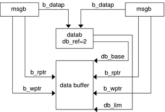

Shared Data
In Figure 7-4, two message blocks are shown pointing to one data block. db_ref indicates that there are two references (mblks) to the data block. db_base and db_lim point to an address range in the data buffer. The b_rptr and b_wptr of both message blocks must fall within the assigned range specified by the data block.
Figure 7-4 Shared Data Block
Diagram shows two message blocks that share a common data block and data buffer.
Data blocks are shared using utility routines (see dupmsg(9F) or dupb(9F)). STREAMS maintains a count of the message blocks sharing a data block in the db_ref field.
These two mblks share the same data and datablock. If a module changes the contents of the data or message type, it is visible to the owner of the message block.
When modifying data contained in the dblk or data buffer, if the reference count of the message is greater than one, the module should copy the message using copymsg(9F), free the duplicated message, and then change the appropriate data.
Note - Hardening Information. At Sun, it is assumed that a message with a db_ref > 1 is a “read-only” message and can be read but not modified. If the module wishes to modify the data, it should first copy the message, and free the original:
if ( dbp->db_ref > 1 ) {
    dblk_t    *newdbp;
    /* Get a copy of the message */
    newdbp = copymsg(dbp);
    /* Free the original */
    freemsg(dbp);
    /* make sure that we are now using the new dbp */
    dbp = newdbp;
