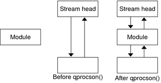

In a multithreaded environment, data can flow up the stream during the open. A module receiving this data before its open routine finishes initialization can panic. To eliminate this problem, modules and drivers are not linked into the stream until qprocson(9F) is called (messages flow around the module). The following figure illustrates this process. See Chapter 12, Multithreaded STREAMS for more information on the multithreaded environment and the use of perimeters.
Figure 7-9 Messages Flowing Around the Module Before qprocson
The module or driver instance is guaranteed to be single-threaded before qprocson(9F) is called, except for interrupts or callbacks that must be handled separately.
Note - Hardening Information. qprocson must be called before calling qbufcall(9F), qtimeout(9F), qwait(9F), or qwait_sig(9F).
Before a module calls qprocson, it must be ready to accept data via the module's put procedure so all data structures must be fully initialized (see put Procedure). The most common method for calling qprocson is to call this function just before returning from a successful open (see Example 7-1).
Note - For a multithreaded environment, verify you are using the correct perimeter before accessing data. See Chapter 12, Multithreaded STREAMS for more information on the multithreaded environment and the use of perimeters.

qprocsoff does the inverse operation shown in Figure 7-9. This supports the need for cancelling callbacks before a qprocsoff.
qprocsoff is typically called at the begining of the close routine. The module can no longer receive messages from adjoining modules. The queue, however, still has pointers to it's adjoining modules and can putnext. However, as the queue is no longer inserted into the stream, these messages may be out of order from other messages in the stream, so it is best to process these messages before qprocsoff.
qwait is used because a module needs to get some response from another module or driver in the STREAM (i.e. a DLPI disconnect message sent downstream). qwait and qwait_sig must also be called before qprocsoff because once the queue is removed from the stream, there will be no way for the reply message to reach the queue.

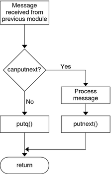

The put procedure is the mechanism that other modules use to pass messages into this module. This procedure is called via the putor putnext routines on behalf of other modules. The queue's put procedure is invoked by the preceding module to process a message immediately (see put(9F) and putnext(9F)). Most modules will have a put routine. The common exception is on the read-side of drivers because there will not typically be a module downstream to the driver.
Note - Hardening Information. putnext is used by adjoining modules to ensure that the next module's queue is intact. Use of put cannot guarantee that the queue being called is currently valid and inserted into a stream; you must ensure that the queue is valid when using put.
A driver's put procedure must do one of the following:
Process and free the message.
Process and route the message back upstream.
Queue the message to be processed by the driver's service procedure.
All M_IOCTL type messages must be acknowledged through M_IOACK or rejected through M_IOCNACK. M_IOCTL messages should not be freed. Drivers must free any unrecognized message.
A module's put procedure must do one of the following as shown in Figure 7-10:
Process the message and pass it to the next module or driver.
Queue the message to be processed later by the module's service procedure.
Unrecognized messages are passed to the next module or driver. The stream operates more efficiently when messages are processed in the put procedure. Processing a message with the service procedure imposes some latency on the message.
Figure 7-10 Flow of put Procedure
If the next module is flow controlled (see canput(9F) and canputnext(9F)), the put procedure can queue the message for processing by the next service procedure (see putq(9F)). The put routine is always called before the component's corresponding srv(9E) service routine, so always use put for immediate message processing.

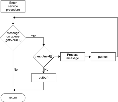

A queue's service procedure is invoked to process messages on the queue. It removes successive messages from the queue, processes them, and calls the put procedure of the next module in the stream to give the processed message to the next queue.
The service procedure is optional. A module or driver can use a service procedure for the following reasons:
Streams flow control is implemented by service procedures. If the next component on the stream has been flow controlled, the put procedure can queue the message. (See Flow Control in Service Procedures in Chapter 7, STREAMS Framework - Kernel Level for more on flow control.)
Resource allocation recovery. If a put or service procedure cannot allocate a resource, such as memory, the message is usually queued to process later.
A device driver can queue a message and get out of interrupt context.
To combine multiple messages into larger messages.
The service procedure is invoked by the STREAMS scheduler. A STREAMS service procedure is scheduled to run if:
The queue is not disabled (noenable(9F)) and the message being queued is either the first message on the queue, or a priority band message.
The message being queued (putq(9F) or putbq(9F)) is a high-priority message,
The queue has been back-enabled because flow control has been relieved,
The queue has been explicitly enabled (qenable(9F)).
A service procedure usually processes all messages on its queue (getq(9F)) or takes appropriate action to ensure it is re-enabled (qenable(9F)) at a later time. Figure 7-11 shows the flow of a service procedure.

Figure 7-10 shows typical processing flow for a put procedure which works as follows:
A message is received by the put procedure associated with the queue, where some processing can be performed on the message.
The put procedure determines if the message can be sent to the next module by the use of canput(9F) or canputnext(9F).
If the next module is flow controlled, the put procedure queues the message using putq(9F).
putq(9F) places the message in the queue based on its priority.
Then, putq(9F) makes the queue ready for execution by the STREAMS scheduler, following all other queues currently scheduled.
If the next module is not flow controlled, the put procedure does any processing needed on the message and sends it to the next module using putnext(9F). Note that if the module does not have a service procedure it cannot queue the message, and must process and send the message to the next module.
Figure 7-11 shows typical processing flow for a service procedure that works as follows:
When the system goes from kernel mode to user mode, the STREAMS scheduler calls the service procedure.
The service procedure gets the first message (q_first) from the message queue using the getq(9F) utility.
The put procedure determines if the message can be sent to the next module using canput(9F) or canputnext(9F).
If the next module is flow controlled, the put procedure requeues the message with putbq(9F), and then returns.
If the next module is not flow controlled, the service procedure processes the message and passes it to the put procedure of the next queue with putnext(9F).
The service procedure gets the next message and processes it. This processing continues until the queue is empty or flow control blocks further processing. The service procedure returns to the caller.

The key attribute of a service procedure in the STREAMS architecture is delayed processing. When a service procedure is used in a module, the module developer is implying that there are other, more time-sensitive activities to be performed elsewhere in this stream, in other streams, or in the system in general.
Note - The presence of a service procedure is mandatory if the flow control mechanism is to be utilized by the queue. If you do not implement flow control, queues can overflow and hang the system.
