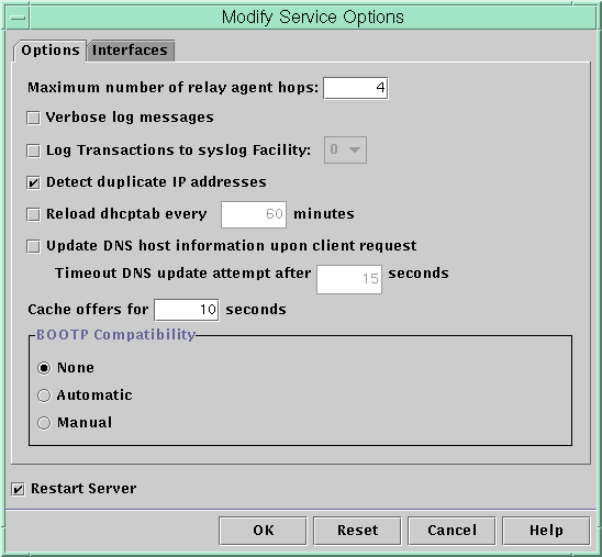

You can change values for some additional features of the DHCP service, which might not have been offered during the initial configuration with DHCP Manager. To change service options, you can use the Modify Service Options dialog box in DHCP Manager. Or you can specify options with the dhcpconfig command.
The following table is a map that describes tasks to modify DHCP service options. The table also includes links to the procedures to accomplish each task.
The following figure shows DHCP Manager's Modify Service Options dialog box.
Figure 15-3 Modify Service Options Dialog Box in DHCP Manager

See How to Start and Stop DHCP Manager for information about DHCP Manager.
The Modify Service Options dialog box opens and displays the Options tab. See Figure 15-3.
The Restart Server option is near the bottom of the dialog box.

# /usr/sadm/admin/bin/dhcpmgr &
See How to Start and Stop DHCP Manager for more detailed information.
The Modify Service Options dialog box opens.

You can change options that affect the performance of the DHCP server. These options are described in the following table.
Table 15-3 Options Affecting DHCP Server Performance
The following procedures describe how to change these options.
See Table 15-3 for information about the options.
If you change options with this procedure, the changed options are used only after the DHCP server is restarted.
