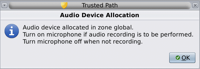

Example 3-4 Allocating an Audio Device
In this example, a user allocates the audio device on her system. When she moves the audio device to the Allocated Device list, the following message appears:
The device is allocated at the label Confidential : Internal Use Only. She views the label when she selects the device in the Allocated Device list.

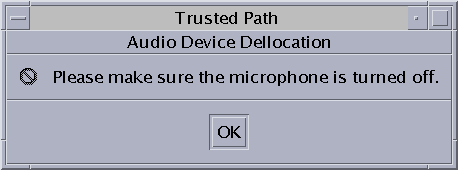

When the user is finished with the audio device, she deallocates it. The system reminds her to turn off the microphone.

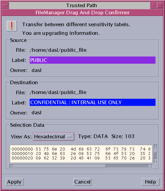

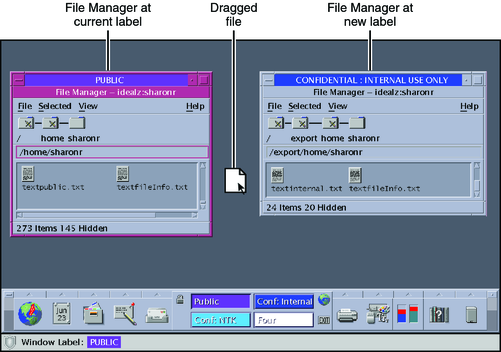

As on a standard Solaris system, you can move files in Trusted Extensions. When you move a file to a different label, you are upgrading or downgrading the sensitivity of the information that is in the file.
Your site's security policy must permit this type of transfer, the containing zone must permit relabeling, and you must be authorized to move files between labels.
Therefore, your administrator must have completed the following tasks:
You must be logged in to a multilevel session in Trusted CDE. The file that you want to move must be closed. Verify that no one else is using this file.
For details, see How to Add a Workspace at a Particular Label.
For details, see How to View Your Files in a Labeled Workspace.
For details, see How to Move a Window to a Different Workspace.
Figure 3-16 Differently Labeled File Managers in One Workspace
Figure 3-17 Dragging a File Between File Managers at Different Labels
The File Manager Confirmation dialog box is displayed, as shown in Figure 3-18.
This dialog box is similar to the Selection Manager Confirmation dialog box, but does not include a timer. This dialog box:
Describes why confirmation of the transaction is needed.
Identifies the label and the owner of the source file.
Identifies the label and the owner of the destination file.
Identifies the type of data that was selected for transfer, the type of the target file, and the size of the data in bytes.
Figure 3-18 File Manager Confirmation Dialog Box
