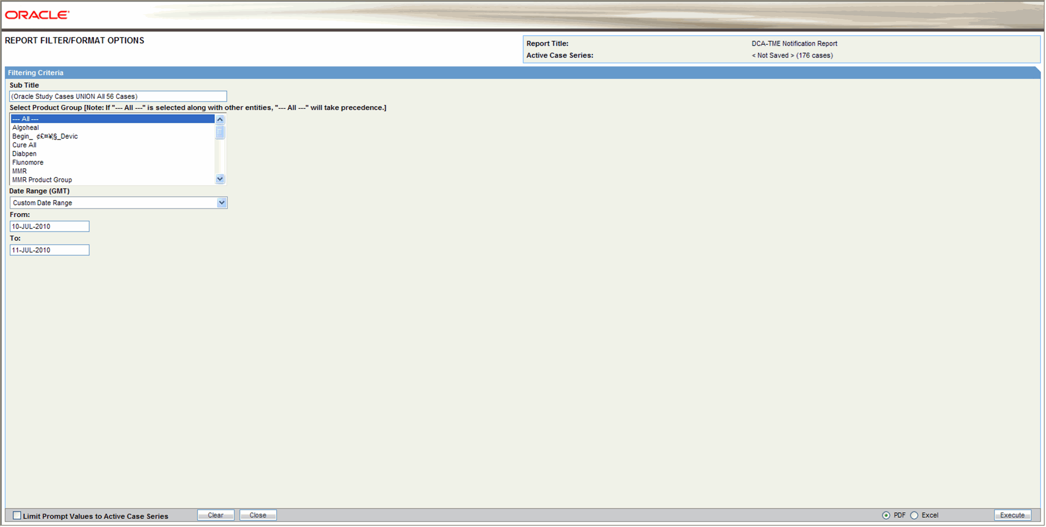

Click Execute to generate the report. A new browser window displays the pre-filter options in the Report Filter page. The following pre-filter elements may be available depending on the type of information the report displays.
List box - this element lets you filter the report output by specifying a single value from the list; for example, the country of incidence, a regulatory authority, or a pre-defined date range. List boxes may also contain options for grouping the report output; for example, grouping by age group or product name
Multiple selection lists - this element lets you filter the report output by multiple values you select from the list; for example, license countries or report types.
Note: If All is selected along with other entities for a category, then all the items under that category are searched. |
Text boxes - this element lets you filter the report output by specifying a numerical value for timelines or dates for date ranges. All the report pre-filter pages contain a text box for specifying a sub-title for the report
The Pre-filter page can display values in Prompts. By default, prompts on the Pre-filter page display values from LM tables.
By default, a checkbox called Limit Prompts Values to Active Case Series is displayed on the Pre-filter page. You can check this checkbox to generate pre-filter prompts and view values limited to the cases in the case series. This impacts only those prompts which are populated from case tables and corresponding LM tables exist for that prompt.
Custom prompts created by the user for ad-hoc reporting do not have the option of displaying values in prompts from LM tables. Custom prompts always display data as per the conditions (SQL) that were defined during the creation of the prompts.
Specify the pre-filter options, as appropriate.

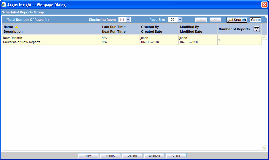

When you select a query and click Associate, the Scheduled Report Groups window is displayed.
This window includes the following features:
This window displays information about all the report groups scheduled by the logged-in user.
Sorting and Search functionality is available for all columns.
Pagination is also available.
Each group can contain one or more reports. "Group" means that all the reports are scheduled at the same time.
This window has the following buttons:
New: Redirects the user to the Report Scheduling page with blank values. The system presents the context menu to enable the user to choose Report Association Only or for Scheduling.
Modify: Redirects the user to the Report Scheduling page and enables the user to modify an existing scheduled report group.
Delete: Deletes a selected scheduled report group.
Execute: Closes the window and executes the query in parent window to show case series and launch pre-filter for the selected report on this page. This button is enabled on if the scheduled report group has a single report.
Close: Closes the window without any other action.

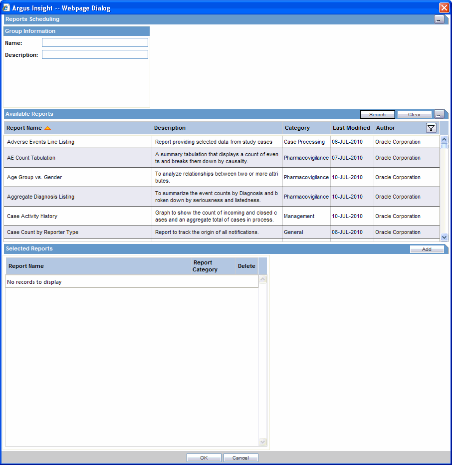

This the main scheduling page in Insight. On this page, user can select any number of reports for scheduling.
The Reports Scheduling page has four (4) sections as follows:
Group Information: The user provides the group name and description.
Schedule Information: The user provides the scheduling frequency.
Email Information: The user provides e-mail information for the receivers.
Available Reports: The user selects the reports to schedule. Select any report and click Add to add the report to Selected reports. The user can select multiple reports and add them at the same time.
Selected Reports: Reports associate with the query (as per the selection by the user from Available Reports section) are listed in this field.
User can remove a selected report by clicking the X button against report's row in the grid from the Selected Reports section.
Sorting and Search functionality is available for all the columns in the Available Reports Section.
Pagination is also available on the Available Reports Section.
The system does not permit the user to save a schedule without entering the pre-filter information for each report. The system uses the value in the Pre-Filters Configured? Column in the Selected Reports section to detect whether the pre-filter configuration is complete.
The user can enter pre-filter information by selecting any report in the Selected Reports section. When the user selects the report, the system loads the pre-filter information for the report in the sidebar and enables the user to enter the information.
Side bar has OK and Cancel buttons
OK: Save the pre-filter information for the selected report.
Clear: Reset the pre-filter page to blank values after confirming with user.

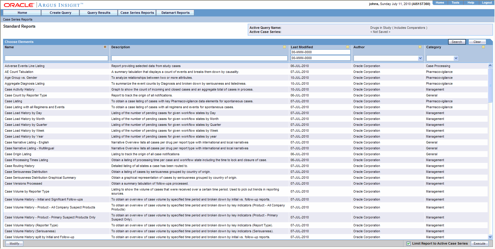

The Standard Reports page displays a list of all the Standard Reports built into Argus Insight. Select Case Series Reports > Standard Reports > All to display the Standard Reports page. This page displays a list of the saved Standard Reports in a grid format. You can search for specific types of reports by specifying values for any of the columns as the search criteria and clicking Search.
The descriptions of the grid columns follow.
| Column | Description |
| Name | Displays the name of the Standard Report |
| Description | Displays the Standard Report description |
| Last Modified | Displays the date when the Standard Report was last modified |
| Author | Displays the name of the Standard Report author |
| Category | Displays the Standard Report Category |

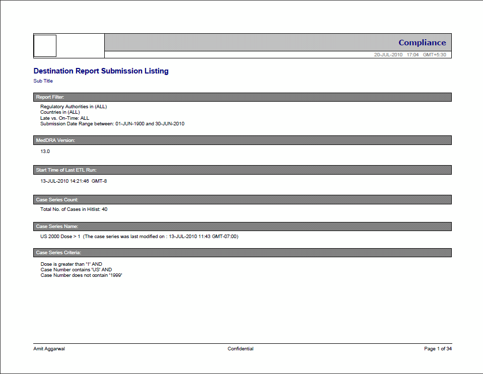

The following image displays the Cover page of the report when it is generated in PDF format.
The following table describes each component of the cover page shown in the above image.
| Cover Page Component | Description |
| Company logo (upper-left box) | Placeholder for a configurable logo. The image of the logo can be configured in the whitespace. |
| Report Category (upper-right box) | The name of the category to which the selected report belongs. |
| Report Execution Date (under 'Report Category') | Report Execution Time (in GMT). |
| Report Title (under the Heading of the Report) | Title of the selected report, such as Serious Adverse Events Report. |
| Report Sub-Title (under 'Report Title') | Configurable Sub-title of the selected report. You can enter a sub-title to further define the report. Example: 01-JAN-1900 to 31-DEC-2007. |
| Report Filter | A selected value from the Report Prompt. |
| MedDRA Version | The MedDRA Version for the selected report. |
| Start Time of Last ETL Run | Start time of the last successful ETL run (in GMT). |
| Case Series Count | A count of the total number of unique cases in the case series. |
| Case Series Name | The name of the saved case series on which the report has been executed. Reports that are run on frozen case series data indicate on the report next to the case series name that "The data in this report was frozen as of <particular date and time>". Time is the database system time with the GMT offset.Reports that are run on normal case series data indicate on the report next to the case series name that "The case series was last modified on <Case series modification date and time>". |
| Case Series Criteria | Query criteria to get case series on which the report has been executed. |
| User Name (bottom-left) | The name of the user who executed the report. |
| Confidential (bottom-centre) | Configurable Confidential text. |
| Page x of y (bottom-right) | Page Number (in Current Page number of Total Pages in the Report format). |
| Footer logo (bottom-right box) | Placeholder for a configurable logo. The image of the logo can be configured in the whitespace. This component may not appear in every report. |
