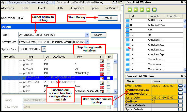

Start a Debug Session
To start a debug session, navigate to the transaction you want to debug. Make sure the transaction is checked-in. Then go into the OIPA application and apply the transaction to an active policy. The transaction should remain in a pending status. Go back to the Rules Palette and set the debug parameters from the Debug pane. The EventList window steps through the math variables and the ContextList window displays the current state of each variable throughout the debug session.
All translation, compilation and runtime errors must first be fixed in order to use the Debug pane. Debug can be performed when the transaction is checked-in or checked-out; however, configuration problems can only be fixed if the transaction is checked out.
Debug Pane of a transaction
Debug Pane and Related Windows
Steps to Start a Debug Session
  1. Double-click on the transaction's XML file.
  2. Open the Debug pane.
  3. Select a policy from the policy drop-down box. The transaction must be a pending activity attached to an active policy.
If debug is performed on a transaction without selecting a policy, a sad server will occur.
  1. Select the ActivityDate if the activity is applied more than once on the policy.
  2. Select the SystemDate if necessary.
  3. Click Debug. If the initiation of the debug session was successful, a success message will display. Click OK.
Step Through a Debug Session
  1. Initiate a debug session using the steps above.
  2. Click Run or Fast Forward to execute each step to the end of the math or to the next breakpoint.
OR
  1. Click Step Forward to move forward one step in the math.
Use Rewind to return to the beginning of the debug session or Step Backward to go back one step in the debug session. The Variable Indicator will step to an instruction, either forward or backward as the previous selection dictates.
ContextList Window
Use the ContextList Window to view the state of the math variable at each step in the debug session. If the value does not fully display in the column, click the ellipsis (...) button to see the full details.
EventWindow
In the EventWindow a blue blue button and green green button button appears next to the math variable execution steps. The blue button indicates the math variable is part of the transaction. The green button indicates the math variable is part of a called function. Double-click on either button to be brought to the math variable in the transaction or function configuration.
Note: The remote debugger does not debug Function rules separately, only as called within a transaction.

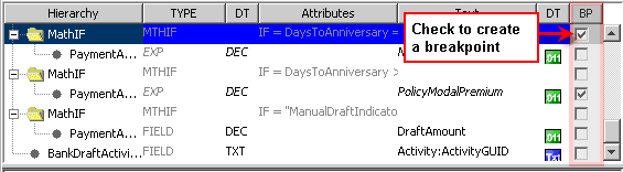

Breakpoints
Another debugging feature is the ability to set-up breakpoint(s) in the configuration. Breakpoints are places in the code where execution is stopped for debugging purposes. In the Rules Palette, select as many breakpoints as needed by checking the BP checkbox. After breakpoints are selected, use the play button play button in EventList window to step through configuration.
Important: Breakpoints can be set for a loop that then displays math variables and associated values for each iteration of the loop. Use the play button play button to step through each iteration of a loop.
Breakpoints in debugging
Breakpoint Column on Debug Pane
To clear all the breakpoints, select the Clear All Clear All button button.
