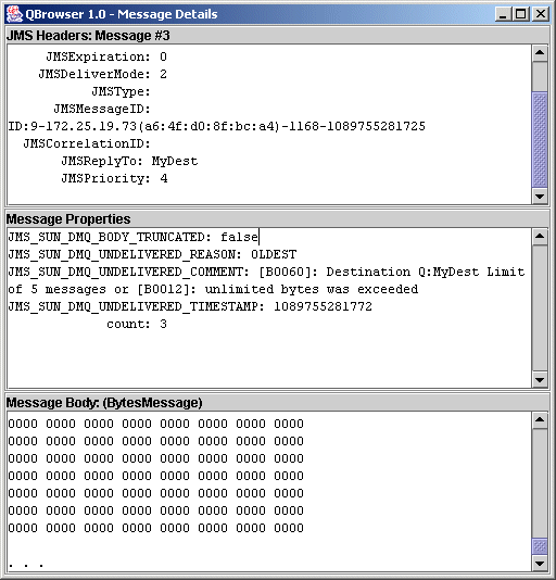

To confirm this cause of the problem: Use the QBrowser demo application to inspect the contents of the dead message queue (see To Inspect the Dead Message Queue).
Check the values for the following message properties:
JMS_SUN_DMQ_UNDELIVERED_REASON
JMS_SUN_DMQ_UNDELIVERED_COMMENT
JMS_SUN_DMQ_UNDELIVERED_TIMESTAMP
Under JMS Headers, scroll down to the value for JMSDestination to determine the destination whose messages are becoming dead.

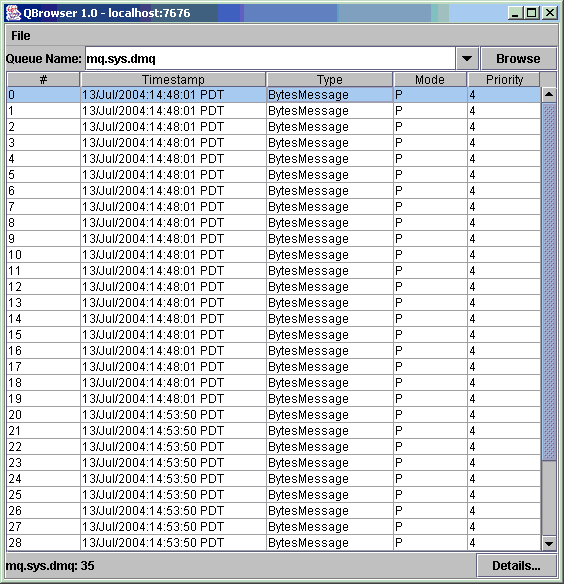

A number of troubleshooting procedures involve an inspection of the dead message queue (mq.sys.dmq). The following procedure explains how to carry out such an inspection by using the QBrowser demo application.
java QBrowser
The QBrowser main window appears.
A list like the following appears:
The display should resemble the following:
You can inspect the Message Properties pane to determine the reason why the message was placed in the dead message queue.
