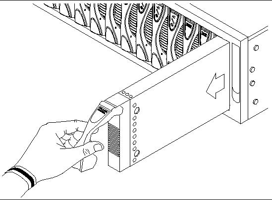

1. Remove the filler panel from an unpopulated slot in a Sun Fire B1600 Blade system chassis or other supported system.
Insert your finger in the pull recess located in lower portion of the filler panel lever and pull gently to disengage the locking mechanism (FIGURE 2-1).
2. Pull the lever mechanism in a forward and upward motion, causing the filler panel lever to unlatch and eject the filler panel partially from the system chassis (FIGURE 2-2).
3. Pull the lever to remove the filler panel from the system chassis (FIGURE 2-3).

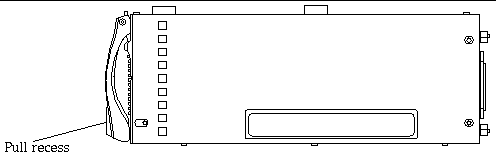

4. If required, open the blade lever by inserting a finger in the pull recess located in lower portion of the blade lever and pull the lever mechanism in a forward and upward motion, causing the lever to unlatch (FIGURE 2-4).

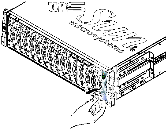

5. Align the Sun Fire B10n blade with an empty slot in the system chassis.
Ensure that the blade connector is facing towards the system chassis, with the hinge point of the lever mechanism uppermost, and support the bottom of the blade with your free hand while lifting the blade up to the system chassis (FIGURE 2-5).
6. Insert the Sun Fire B10n blade into the system.
Caution - Ensure that the blade engages with the system chassis guidance system. Failure to align the blade correctly can result in damage to the chassis midplane or the blade connection. |

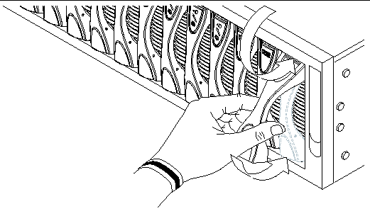

7. Gently push the blade into the slot until the blade latch ears, on top of the lever, are positioned in the chassis (FIGURE 2-6).
8. Complete the hardware installation by closing the blade lever fully, which engages the blade into the chassis slot (FIGURE 2-6).
The green LED flashes as the blade powers up, and glows steadily when the blade is up and running.

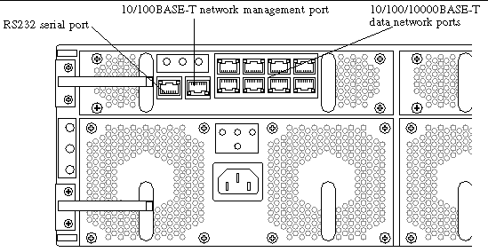

All ports and are located at the back of the Sun Fire B1600 blade system chassis. These connections are shown in FIGURE 2-7.
Note the location of the following ports:
Note - Twisted-pair cables must not exceed 328 feet (100 meters). |

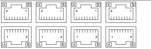

Arranged as a 4x2 array, these RJ-45 ports provide the connection to the combined switch and service processor. Each port has integral green Link Present and Link Active LED indicators.
Note - The Link Present indicator is always on the left, regardless of the orientation of the RJ-45 port. |
Viewing the Sun Fire B1600 blade system chassis from the back, pin 1 of the RJ-45 serial port is on the left, and pin 8 is on the right.
