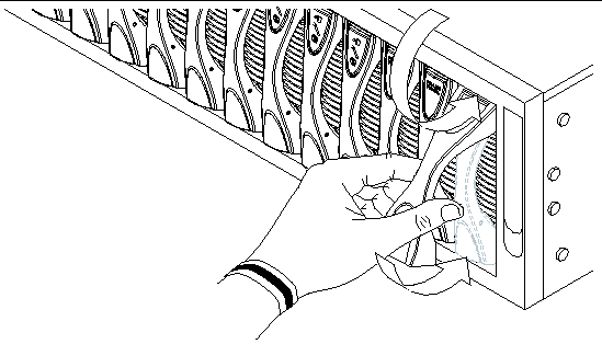

1. Remove the filler panel from an unpopulated slot in a Sun Fire B1600 blade chassis or other supported system.

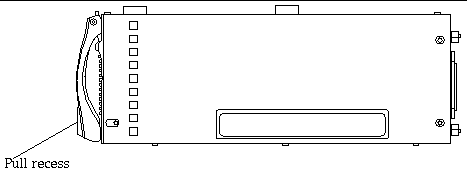

Insert your finger in the pull recess located in lower portion of the filler panel lever and pull gently to disengage the locking mechanism (FIGURE 2-1).

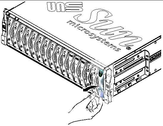

2. Pull the lever mechanism in a forward and upward motion, causing the filler panel lever to unlatch and eject the filler panel partially from the Sun Fire B1600 blade chassis (FIGURE 2-2).
3. Pull the lever to remove the filler panel from the Sun Fire B1600 blade chassis (FIGURE 2-3).
4. If required, open the blade lever by inserting a finger in the pull recess located in lower portion of the blade lever and pull the lever mechanism in a forward and upward motion, causing the lever to unlatch (FIGURE 2-4).

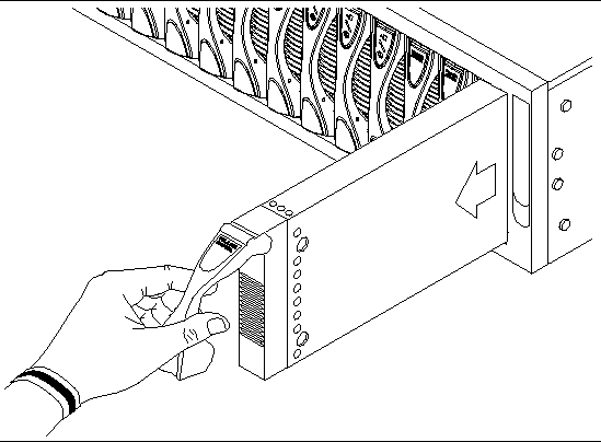

6. Insert the SSL proxy blade into the system.

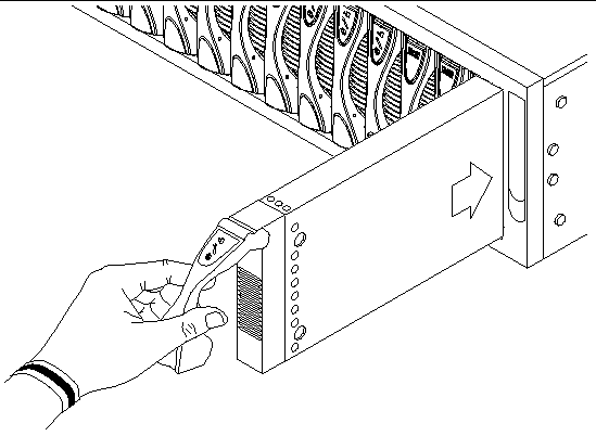

7. Gently push the blade into the slot until the blade latch ears, on top of the lever, are positioned in the Sun Fire B1600 blade chassis (FIGURE 2-6).
8. Complete the blade installation by closing the blade lever fully, which engages the blade into the Sun Fire B1600 blade chassis slot (FIGURE 2-6).

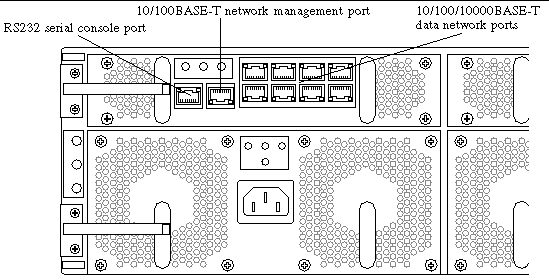

All ports are located at the back of the Sun Fire B1600 blade chassis. These connections are shown in FIGURE 2-7.
Note the location of the following ports:
Note - Twisted-pair cables must not exceed 328 feet (100 meters). |

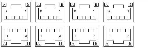

Arranged as a 4x2 array, these RJ-45 ports provide the connection to the Combined Switch and Service Processor (CSSP). Each port has integral green Link Present and Link Active LED indicators.
Note - The Link Present indicator is always on the left, regardless of the orientation of the RJ-45 port. |
Viewing the Sun Fire B1600 blade chassis from the back, pin 1 of the RJ-45 serial port is on the left, and pin 8 is on the right.
