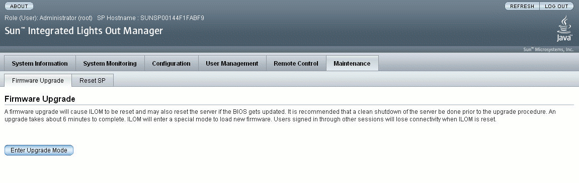

1. Log in to the ILOM web interface as Administrator.
2. Select Maintenance --> Firmware Upgrade.
The Firmware Upgrade page appears.
FIGURE 11-1 Firmware Upgrade Page
A dialog box appears asking you to confirm that you want to enter Upgrade mode.
4. Click OK to enter Upgrade mode or Cancel to exit the process.

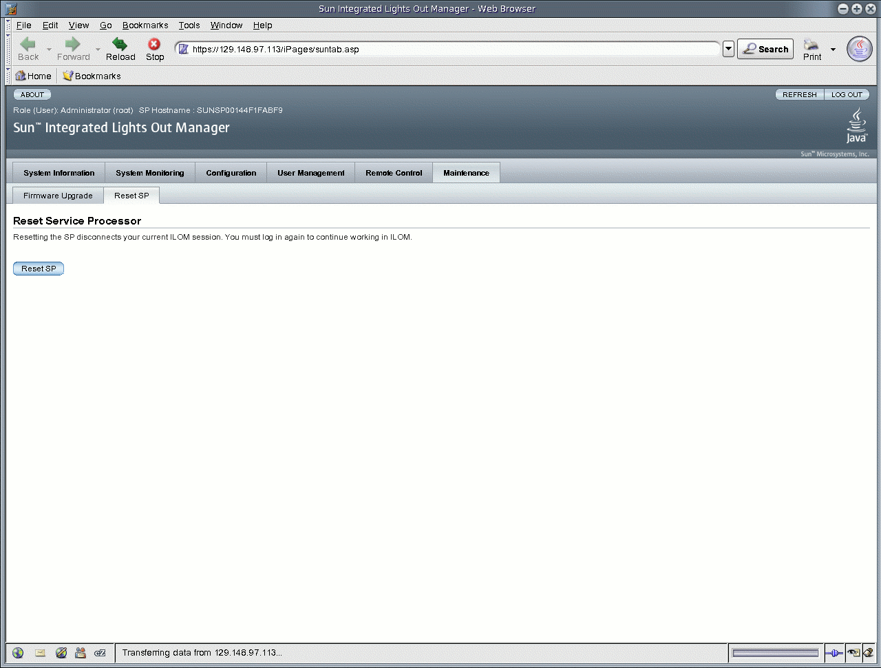

After updating the ILOM/BIOS firmware, you must reset the ILOM SP.
  To reset the ILOM SP, you can do any of the following:
FIGURE 11-2 Reset Service Processor Page
ipmitool -U root -P password -H SP-IP bmc reset cold
where SP-IP is the IP address of the service processor.
