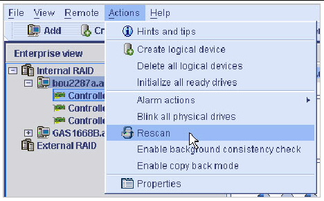

To Rescan an HBA |
After you connect a disk drive to or remove a ‘Ready’ (non-failed) disk drive from an HBA, the Sun StorageTek RAID Manager software may not recognize the change until it rescans the HBA.
1. In the Enterprise View, click the HBA.
2. From the menu bar, choose Actions > Rescan.
FIGURE 10-4 Rescanning the HBA
The Sun StorageTek RAID Manager software scans all the channels or ports on the HBA you selected.
When the scan is complete, a report is displayed.
3. Click Done after you have reviewed the scan report.

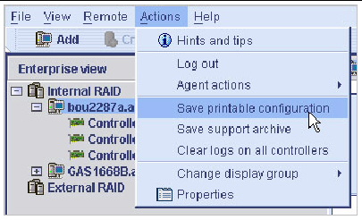

To Save The HBA Configuration |
If you require a record of your HBA configurations, you can use the Sun StorageTek RAID Manager software to create a text file with this information about all HBAs on a selected system:
1. In the Enterprise View, click the local or remote system.
2. From the menu bar, choose Actions > Save printable configuration.
FIGURE 10-5 Saving the HBA Configuration

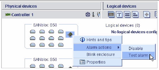

To Test an Enclosure Alarm |
1. Ensure that the speakers on your local system are not muted.
2. In the Enterprise View, select the HBA that is connected to the enclosure you want.
3. In the Physical Devices View, right-click the enclosure icon of the enclosure that you want.
A navigational menu is displayed.
4. Choose Alarm actions > Test alarm.
FIGURE 10-6 Testing the Enclosure Alarm
5. To stop the test, click OK.

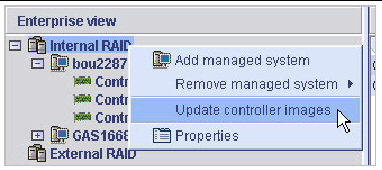

The Sun StorageTek RAID Manager software provides a wizard to help you update the BIOS and firmware for the HBAs in your storage space. The ROM Update wizard updates the BIOS and firmware for all HBAs of the same type on local and remote systems. You can update one type of HBA at a time.
Before you begin, download the latest firmware images from http://support.intel.com/support/go/sunraid.htm. Image files typically come in sets of two or more and have a .ufi file extension.
To Update the HBA BIOS and Firmware |
1. In the Enterprise View, right-click Direct attached storage.
2. Choose Update controller images.
FIGURE 10-8 Updating the HBA BIOS and Firmware
