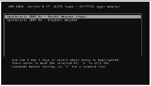

The server module’s console is automatically directed to the serial port. GRUB, the open source boot loader, is the default boot loader in the OpenSolaris OS for x86-based or x64-based systems. The boot loader is the first software program that runs after you power on a system.
1. Use a cable to connect the serial port of the host server (either through the chassis SER MGT port or through a dongle cable’s serial port) to the video port of the client system.
2. From the GRUB menu, you have the option of displaying the installation process to a VGA connection (video port) as shown here:
3. To display output to the video port, choose the following option:
OpenSolaris 2009.06 - Graphics Adapter
The GRUB menu on the preinstalled image has been configured for an infinite timeout so that you can choose the console output on power-up. However, you can modify this setting so that your system boots automatically.
To modify the GRUB menu to auto boot, edit the /rpool/boot/grub/menu.1st file as follows:
a. Change the -1 value on the timeout line to reflect the duration you want the menu to be presented.
For example, for a 10-second delay, set the -1 on the timeout line to 10.
b. Add a line that specifies the defaults boot entry.
For example, to specify the first entry, set the defaults to 10.

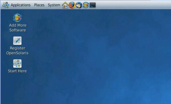

For information on getting started with OpenSolaris, click the Start Here icon on the OpenSolaris Desktop.
