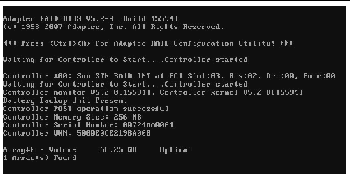

- If you have a boot disk with an existing bootable array volume (and it is not part of an existing RAID that you want to keep) and you want to overwrite it to install Windows, no other disk preparation is required. During the Windows operating system installation you will be presented the option to overwrite any existing partition(s) within the array volume. The following figure shows an example of system with an existing bootable Sun Blade REM array volume.
FIGURE 7-1 Example Startup Screen Showing Existing Sun Blade REM Array Volume

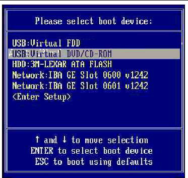

4. Once the BIOS POST process is complete, the Boot Device menu appears (see FIGURE 7-3). If you have selected the Windows Local installation method, insert the Windows Server 2008 media DVD in the server’s DVD drive now.
FIGURE 7-3 Boot Device Menu Example
5. Select CD/DVD from the Boot Device menu and press Enter.

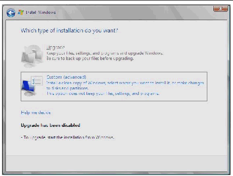

6. The Windows installation wizard starts. Proceed through the installation wizard until you see the Installation Type page displayed, and then click Custom (advanced).
FIGURE 7-4 Select Installation Type Page

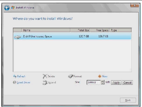

7. You will then see the Where to Install Windows page (see FIGURE 7-5), do one of the following:
FIGURE 7-5 Where to Install Windows Page Example
- If you do not want to override the Windows default partition settings, click Next and skip to Step 9.
- If you do want to override the Windows default partition settings, click Driver Options (advanced) and proceed to the next step.
Caution - Formatting or re-partitioning a pre-existing partition will destroy all data on the partition.
8. At the Advanced Driver Options page (see FIGURE 7-6), do the following:
FIGURE 7-6 Windows Partition Management Page
a. Click Delete to delete the existing partition.
b. Click New to create the new partition.
c. Change size settings as needed, and then click Apply.
d. Click Next and proceed to the next step.
