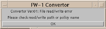

When fwconvert encounters these conditions, it displays an error message in the FW-1 Convertor dialog box, as shown in Figure 7-2.

Click the OK bar to clear the error message in the FW-1 Convertor dialog box.
Change permissions on the affected directories, if applicable.
Fill in the corrected information in the fwconvert FW-1 Convertor dialog box, making sure you have the accurate path names and file names that you need to specify.
Click the Retry button.
