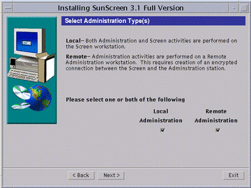

Proceed through the installation windows accepting the default choices, until the Select Administration Type(s) window appears.
In this window (as shown in the following figure), you are given the choice of Local Administration or Remote Administration, with Local Administration as the default. Select Remote Administration.
Select Remote Administration and click Next.

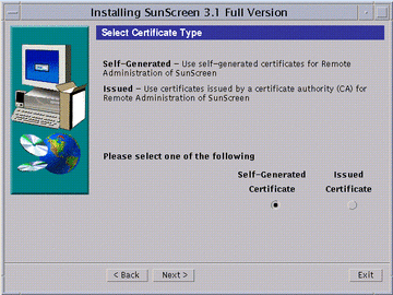

Click Next to proceed through the installation until the Select Certificate Type window appears (as shown in the following figure). Self-Generated Certificate is the default. You have to make a choice at this point whether you are going to use self-generated certificates or issued certificates.
If you are using self-generated certificates, follow instructions a-i through iii, then go to Step 7. If you are using issued certificates, follow instructions b-i through iv, then go to Step 7.
Self-Generated Certificates Only
Accept the default (Self-Generated Certificate) and click Next.

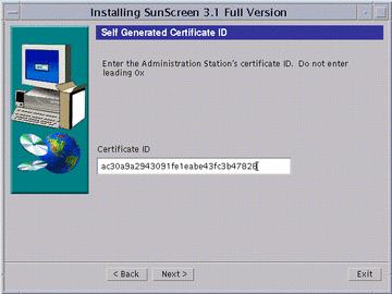

The Self-Generated Certificate ID window appears (as shown in the following figure).
Type the Administration Station's 32-character certificate ID (MKID), obtained in the previous procedure. Do not type the leading two characters: 0x. After you type the certificate ID, click Next.

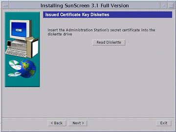

From the Select Certificate Type window, select Issued Certificate and click Next. The Issued Certificate Key Diskettes window appears (as shown in the following figure).
Insert the Administration Station's Key and Certificate diskette and click Read Diskette.
Wait until the issued certificate ID appears at the bottom of the window (as shown in the following figure).
Write down the Administration Station's eight-character certificate ID, and click Next.

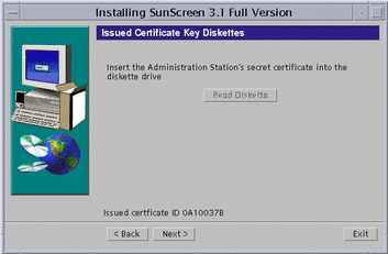

The issued certificate ID for the Screen appears at the bottom of the window.
Write down the Screen's eight-character certificate ID, then go to Step 7.

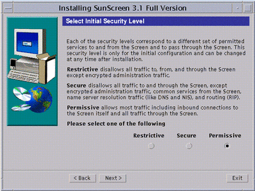

The Select Initial Security Level window appears (as shown in the following figure).
Select the level of security you want.
When in doubt, select Permissive as your initial security level. You can change this level later as needed. See "Deciding on Your Initial Security Level" if you need more information.
Click Next.

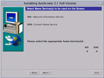

The Select Name Service(s) to be used on the Screen window appears (as shown in the following figure). The default entry is to use both NIS and DNS. You can deselect either one or if you do not want to use a name service, you can deselect both.
Select the appropriate name service(s), and click Next.
