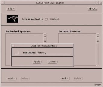

    Next, you add a default ACL to talk unencrypted to all hosts.
  3. Click the Add button, and under Host, choose the Off security option.
    The Add Host properties window appears (as shown in the following figure).
  4. Type `default' as the Hostname and click Apply.
    Figure 4-15 Skiptool With Add Host Properties Window Completed

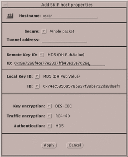

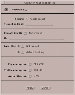

  5. Next, you add an ACL entry for the Screen. Click the Add button, and under Host, choose the SKIP security option.
    The Add SKIP Host Properties window appears (as shown in the following figure).
    Figure 4-16 Add SKIP Host Properties Window
    Graphic
    Use the information contained in the AdminSetup.readme file (see "To Display the AdminSetup.readme File") to complete the fields.
  6. Type the name of the Screen in the Hostname field.
  7. In the Secure field, select Whole Packet from the pull-down menu.
  8. In the Remote Key ID field, make the appropriate selection from the pull-down menu.
    Refer to the AdminSetup.readme file to select the correct Remote Key ID. For self-generated certificates on the Administration Station, select MD5 (DH Public Value). For issued certificates, select IPv4. See the following figure for a sample of the Add SKIP Host Properties window completed.
    Figure 4-17 Add SKIP Host Properties Window Completed
    Graphic
  9. In the Local Key ID field, make the appropriate selection from the pull-down menu.
    Refer to the AdminSetup.readme file to select the correct Local Key ID. For self-generated certificates on the Administration Station, select MD5 (DH Public Value). For issued certificates, select IPv4. The ID value is filled in automatically.
