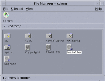

  1. Insert the SunScreen CD-ROM into the CD-ROM drive.
    A File Manager screen appears listing the CD contents (as shown in the following figure).
    Figure 3-1 File Manager Window
    Graphic
  2. Start the installation by double-clicking on the installer icon.

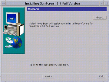

    Enter the root password for your system when prompted. The installer's Welcome window appears (as shown in the following figure)
    Figure 3-2 SunScreen Welcome Window
    Graphic

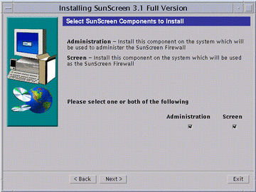

    The Select SunScreen Components to Install window appears (as shown in the following figure)
    Figure 3-3 Select SunScreen Components Window
    Graphic
    Since this is a local administration installation, you need both the Administration and Screen software.
  4. Make sure both Administration and Screen boxes are checked, then click Next to continue.

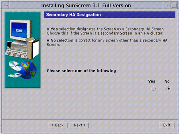

    The Secondary HA Designation window appears with a No as the default entry (as shown in the following figure). This window only applies to the special case of installing secondary (failover) systems in a high availability configuration (see the SunScreen Administration Guide and the SunScreen Configuration Examples document for more information on HA configurations).
    Figure 3-5 Secondary HA Designation Window
    Graphic
  6. Click Next to continue.

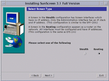

    The Select Screen Type window appears with Routing mode as the default entry (as shown in the following figure).
    Figure 3-6 Select Screen Type Window
    Graphic
  7. Click Next to continue.

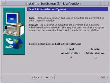

    The Select Administration Type(s) window appears (as shown in the following figure) with Local Administration as the default entry.
    Figure 3-7 Select Administration Type(s) Window
    Graphic
  8. Click Next to continue.

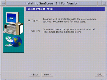

    The Select Type of Install window appears (as shown in the following figure). You have two choices: Typical Install or Custom Install.
    Figure 3-8 Select Type of Install Window
    Graphic
  9. Select the type of install desired, and click Next.

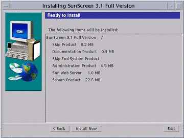

    Next, the disk space on your machine is checked. An error message appears if you do not have enough disk space. If you have enough space, the Ready to Install window appears (as shown in the following figure).
    Figure 3-9 Ready To Install Window
    Graphic
  10. Click Install Now to continue.

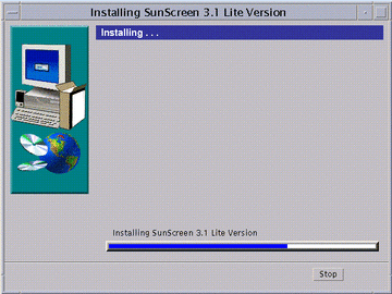

    The Installing window appears with a status bar showing the progress of the installation (as shown in the following figure).
    Figure 3-10 Installing Window
    Graphic

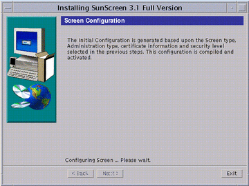

    The Screen Configuration window appears with the message: Configuring Screen(as shown in the following figure). A message appears once the Screen successfully configures.
    Figure 3-13 Screen Configuration Window
    Graphic
