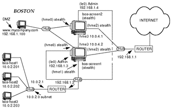

For the network example, shows the Boston segment of the network. Looking at the diagram, two stealth-mode Screens, bos-screen1 and bos-screen2, are used to demonstrate HA.
Figure 7-1 Boston Segment of the Sample Company Network
