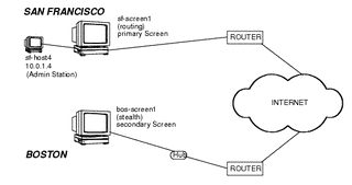

For the network example, shows the San Francisco and Boston segments of the network. Looking at the diagram, sf-screen1 is the primary routing-mode Screen and bos-screen1 is the secondary Screen running in stealth mode. Additional Screens (both stealth and routing modes) can be added as secondary Screens by following this same procedure.

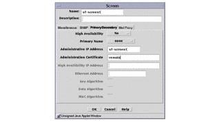

Screen object for primary Screen sf-screen1 containing the administrative IP Address (sf-screen1) and certificate (remote) under the HA/Master Config Tab, as shown in the following figure.

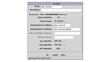

Modify the Screen object for bos-screen1 to show sf-screen1 as the primary Name, and be sure it contains bos-admin1 as the Administrative IP Address and bos-screen1.admin as the Administrative Certificate, as shown in the following figure.

Screen object for bos-screen1 containing sf-screen1 as the primary Name, bos-admin1 as the Administrative IP Address, and bos-screen1.admin as the Administrative Certificate.
This looks the same as it did on the secondary Screen, as shown in Figure 8-3.
