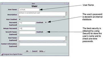

This example shows six user names that need access to the 10.0.3.0 network: William, Henry, Beatrice, Eugenie, Peter, and Zara.
Define each of your users as an Authenticated User, as shown in the following figure:

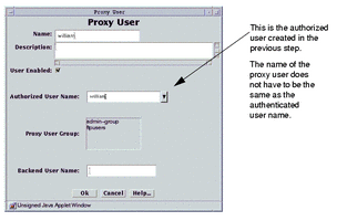

Define each of your users as a Proxy User, as shown in Figure 9-3.
That is, define only those users who are qualified to use the proxy for authentication.
