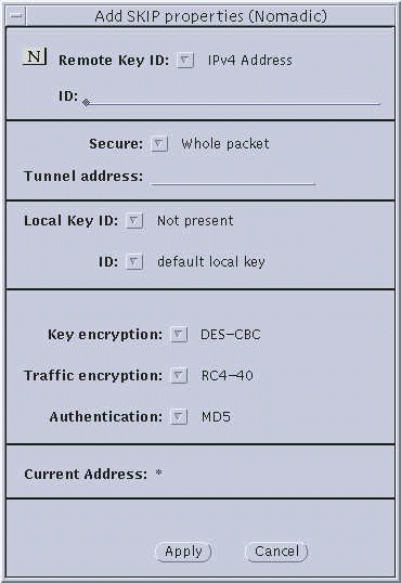

Click and hold on the Add button at the bottom of the authorized systems list on skiptool's Main Window.

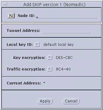

Select the type of connection being authorized: Host, Network, or Nomadic.
Pull right on the type of connection and select the type of encryption that you want to use.
If the remote host system also uses SKIP and the traffic between your systems is to be encrypted, select SKIP.
For systems using Sun Microsystems' SunScreen SPF-100, select SKIP Version 1.
On the Add properties window, enter the name or IP address of the host system to be added to your ACL.
Determine whether Whole packet (tunnel mode) or Data only (transport mode) is secure by clicking on the appropriate selection for the Secure button.
Each type of encryption requires that certain options be set.
The parameters selected are determined by the type of system being authorized and your security policies. The options to be considered are based on the method of encryption selected. They are
For systems using SKIP: Tunnel address, Remote Key ID, Local Key ID. If you leave the tunnel address blank, it will default to the peer's address.
For SKIP Version 1: Key ID, Tunnel address.
Select the appropriate algorithms buttons for Key encryption, Traffic encryption, and Authentication.
The options available for each system are based upon the method of encryption selected from the Security pop-up menu:
Key Encryption button: Selecting this button lists the available key encryption algorithms. The algorithm available is determined by the type of system and selected method of encryption. Please see Table 2-2, "Available Key and Traffic Encryption Algorithms," on page 67.
Traffic Encryption button: Selecting this button lists the algorithms available for encryption between your system and the remote system. The algorithms that are available for key and traffic encryption depend on the packages that were installed on the system, such as core product and key upgrades. The algorithms available determine the type of system and the method of encryption selected. Please see Table 2-2, "Available Key and Traffic Encryption Algorithms," on page 67.
Authentication button: Use this button to select the type of authentication for the packets.
Click Apply to add the host to the authorized systems list.
Refer to the previous section for descriptions of the fields and buttons.

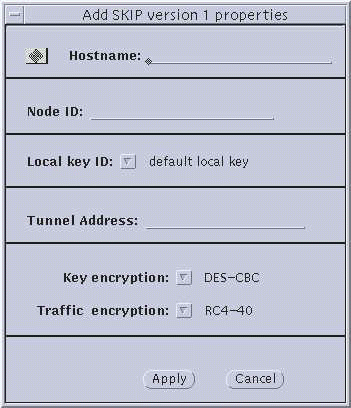

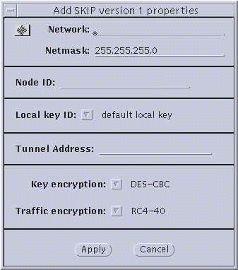

Complete the following steps to set these fields for encrypted traffic between your server and the system to be authorized.
After selecting the type of system and setting the security to SKIP, enter the Hostname.
Enter the Node ID.
This is the IPv4 key ID.
Local Key ID and ID buttons.
Use the Local Key ID button to indicate whether you want your local system to send its key ID in the SKIP packet.
Set the Tunnel Address, if you are using topology hiding.
Tunnel addressing is generally used for clients of encrypted gateways where the IP address of the host entered here serves as the intermediary for any or all hosts on a network whose topography is to remain unknown or hidden from the rest of the world.
Select the appropriate key and traffic algorithms for the Key and Traffic encryption buttons.
The available key and traffic encryption algorithms depend on the which version of SKIP you are using: 512 bitl, 1024 bit, 2048 bit, 4096 bit. To see which options are available, please see Table 2-2, "Available Key and Traffic Encryption Algorithms," on page 67.

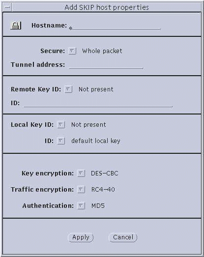

Set the Secure button to either Whole packet (tunnel mode) or Data only (transport mode).
Whole packet is recommended because it offers a greater degree of security.
Set the Tunnel address, if you are using topology hiding.
Use the Remote Key ID button to select whether you would like the remote system's keyID included in SKIP packets.
If so, what namespace does that key occupy. By selecting Not Present, the receiver key ID is not sent.
Not Present is the default. It uses the IP address of the remote system to identify its certificate. If a remote system has a key ID other than identified by its IP address, set the namespaces and indicate the remote system's key ID in the ID Field. The namespace indicated in the Remote Key ID field is determined by the type of certificate that is used or obtained for this system. The type of certificate and the Remote Key ID field for that certificate is shown in the following table:
Table 3-3 Type of Certificate and Remote Key ID Field|
Certificate Type |
Remote Key ID Field |
CA (Sun or other) |
IPv4 |
Self-generated unsigned key |
MD5 (DH Public Value) |
The following namespaces are used in this menu:
Not present |
IPv4 Address |
MD5 (DH public Value) |
If the Remote Key ID field has been set to something other than Not Present, enter the key ID in hexadecimal format in the ID field (0x0a000000).
It must contain the appropriate key ID for the system that is being authorized based upon the selection made in the Remote Key ID field. Depending on the type of certificate, this information may be obtained from the master keyID on the diskette or from the Local key ID field of the other host.
The available options that appear depend on which version of SKIP you are using. versions Available options include: 512 bit, 1024 bit, 2048 bit, or 4096 bit. See Table 2-2, "Available Key and Traffic Encryption Algorithms," on page 67 for more information.
Authentication button.
Use the authentication button to select the type of authentication for the packets. Currently, SunScreen supports MD5 and MD5-NAT. You can also select None for no authentication.
