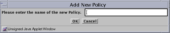

To Add a New Policy
  1. Select a policy in the Policies List page.
    Graphic
  2. Click the Add New button.
    The Add New Policy dialog box appears.
    Graphic
  3. Type the name of the new policy in the Add New Policy dialog box.
  4. Click the OK button.

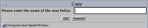

To Copy a Policy
    Graphic
  2. Select the policy you want to copy.
  3. Click the Copy button.
    The Copy dialog box appears.
    Graphic
  4. Type the name of the new policy in the Copy dialog box.
  5. Click the OK button.

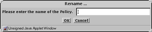

To Rename a Policy
    Graphic
  2. Select the policy you want to rename.
  3. Click the Rename button.
    The Rename dialog box appears.
    Graphic
  4. Type the name of the new policy in the Rename dialog box.

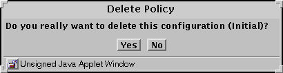

To Delete a Policy
    Graphic
  2. Select the policy you want to delete.
  3. Click the Delete button.
    The Delete Policy dialog box appears.
    Graphic
  4. Click the Yes button in the Delete Policy dialog box to delete the policy.

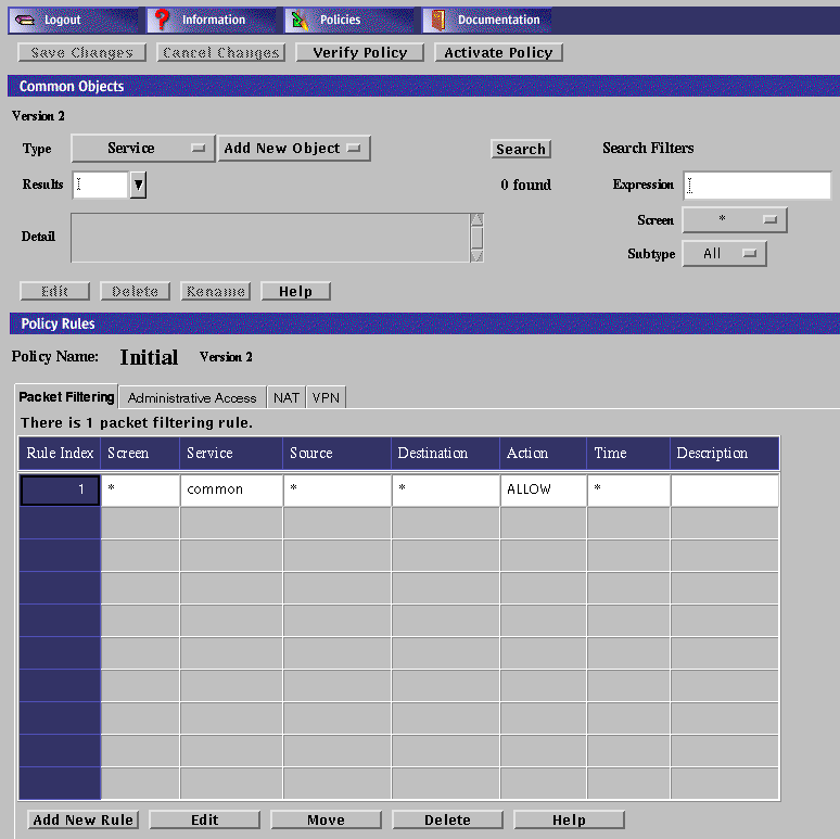

To Verify a Policy
To verify that any changes you have made are stable:
    Graphic
    Select the Policy you want to verify.
    Click the Edit button.
    The Policy page for the selected policy appears.
    Graphic
    Click the Verify Policy button above the Common Objects area.
    Clicking the Verify Policy button verifies that all the rules are valid and should compile successfully when you activate this policy. The rules in the chosen policy file are checked for errors, but the policy is not activated. Verifying a policy allows you to debug it without activating it.
You can activate the policy when verification has succeeded.

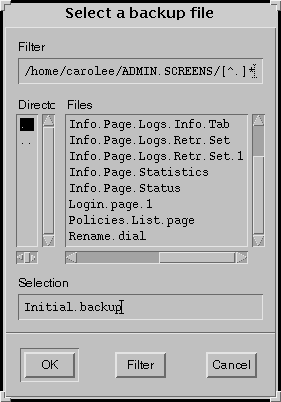

To Back Up All Policies
Backing up your policies is always good practice, especially if anything happens to the disk. You also should back up the original policy after you install SunScreen. This makes it easier to restore earlier policies, if necessary. Backing up from the administration GUI backs up only the current versions of all the policies.
Caution - Caution -
The backup medium contains copies of the local identities (the encryption keys and certificates) and must be stored securely and disposed of properly to avoid compromising your security.
Note -
This procedure requires a browser that can be used to access Local files. You can use the HotJava Browser, Netscape, or Internet Explorer with Sun's Java Plug-In and the identitydb.obj file (copied to the correct location). See "To Install the Java Plug-In on the Screen" for informationon how to install the plug-in.
    Graphic
  2. Click the Backup All button to back up the current version of the policies.
    The Select a backup file dialog box appears.
    Graphic
  3. Type the path name of the directory in the Filter field and type the name of the backup file in the Selection field.
