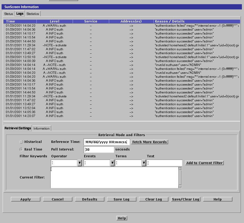

  1. From the Information page, click the Log button.
    The Log page appears.
    Graphic
  2. Click the Save Log button at the bottom of the Log page.
    The Save File dialog box appears.
  3. Type the full path (including file name) of the file where you want to store logs.
    Graphic
  4. Click the OK button.
    Graphic
  2. Click the Clear Log button at the bottom of the panel.
    Graphic
  2. Click the Save/Clear Log button.
  4. Click the Save button.
