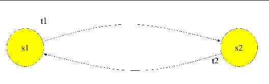

FSM Example
CODE EXAMPLE 1-1 implements a simple state machine depicted in FIGURE 1-1.
FIGURE 1-1 Finite State Machine Example
CODE EXAMPLE 1-1 Finite State Machine Code Example
#include <stdio.h>
#if NUM_CONTEXTS == 1
#define TEJA_FSM_SINGLE_CONTEXT
#endif
#include "fsm/teja_fsm.h"
typedef struct Context
  void * state;
  int count;
} Context;
static Context contexts[NUM_CONTEXTS];
#define ctx_scheduler() (&contexts[0])
#else
void *
ctx_scheduler (void)
  static int i = -1;
  i = (i + 1) % NUM_CONTEXTS;
  return &contexts[i];
#endif
void *
ctx_iterator (void)
  static int i = -1;
  void * cur_context = 0;
  i = (i + 1);
  if (i < NUM_CONTEXTS)
    cur_context = &contexts[i];
  else
    i = -1;
  return cur_context;
teja_fsm_declare (my_fsm);
teja_fsm_begin (my_fsm, s2, ctx_scheduler, ctx_iterator)
  teja_fsm_state_declare (s1);
  teja_fsm_state_declare (s2);
  teja_fsm_state_begin (s1)
    printf ("t1\n");
    ((Context *) TEJA_FSM_CONTEXT)->count++;
    teja_fsm_goto_state (s2);
  teja_fsm_state_end ()
  teja_fsm_state_begin (s2)
    printf ("t2: %d\n", contexts[0].count);
    if (((Context *) TEJA_FSM_CONTEXT)->count == 100)
     teja_thread_shutdown();
    teja_fsm_goto_state (s1);
  teja_fsm_state_end()
teja_fsm_end()
void
fsm_main (void)
  int i;
  for (i = 0; i < NUM_CONTEXTS; i++)
      contexts[i].count = 0;
  teja_fsm_start (my_fsm);
