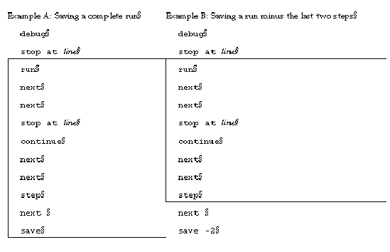

The dbx tool provides three commands for saving all or part of a debugging run and replaying it later:
The save command saves to a file all debugging commands issued from the last run, rerun, or debug command up to the save command. This segment of a debugging session is called a debugging run.
The save command saves more than the list of debugging commands issued. It saves debugging information associated with the state of the program at the start of the run--breakpoints, display lists, and the like. When you restore a saved run, dbx uses the information in the save-file.
You can save part of a debugging run; that is, the whole run minus a specified number of commands from the last one entered. Example A shows a complete saved run. Example B shows the same run saved, minus the last two steps
If you are not sure where you want to end the run you are saving, use the history command to see a list of the debugging commands issued since the beginning of the session.
Note - By default, the save command writes information to a special save-file. If you want to save a debugging run to a file you can restore later, you can specify a file name with the save command. See Saving a Series of Debugging Runs as Checkpoints. |
To save an entire debugging run up to the save command, type:
To save part of a debugging run, use the save number command, where number is the number of commands back from the save command that you do not want saved.
If you save a debugging run without specifying a file name, dbx writes the information to a special save-file. Each time you save, dbx overwrites this save-file. However, by giving the save command a filename argument, you can save a debugging run to a file that you can restore later, even if you have saved other debugging runs since the one saved to filename.
Saving a series of runs gives you a set of checkpoints, each one starting farther back in the session. You can restore any one of these saved runs, continue, then reset dbx to the program location and state saved in an earlier run.
