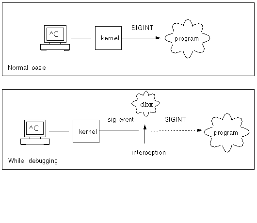

When a signal is to be delivered to a process that is being debugged, the signal is redirected to dbx by the kernel. When this happens, you usually receive a prompt. You then have two choices:
  FIGURE 14-1 Intercepting and Cancelling the SIGINT Signal
Diagram of the normal case where the signal is delivered and the debugging case where the signal is intercepted and cancelled by dbx.
