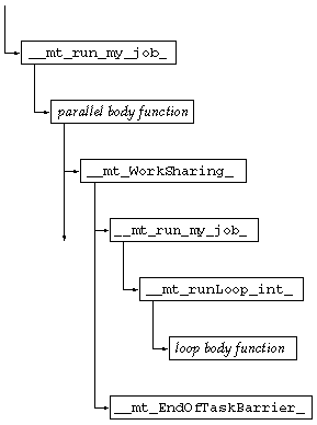

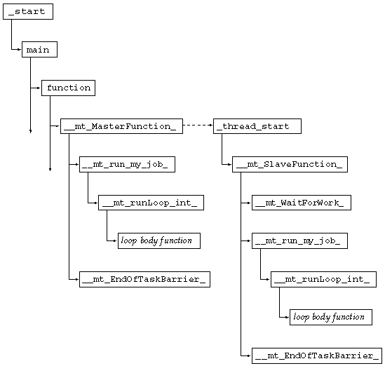

Parallel Execution and Compiler-Generated Body Functions
If your code contains Sun, Cray, or OpenMP parallelization directives, it can be compiled for parallel execution. OpenMP is a feature available with the Suntrademark ONE Studio compilers. Refer to the OpenMP API User's Guide and the relevant sections in the Fortran Programming Guide and C User's Guide, or visit the web site defining the OpenMP standard, http://www.openmp.org.
When a loop or other parallel construct is compiled for parallel execution, the compiler-generated code is executed by multiple threads, coordinated by the microtasking library. Parallelization by the Sun ONE Studio compilers follows the procedure outlined below.
Generation of Body Functions
When the compiler encounters a parallel construct, it sets up the code for parallel execution by placing the body of the construct in a separate body function and replacing the construct with a call to a microtasking library function. The microtasking library function is responsible for dispatching threads to execute the body function. The address of the body function is passed to the microtasking library function as an argument.
If the parallel construct is delimited with one of the directives in the following list, then the construct is replaced with a call to the microtasking library function _ _mt_MasterFunction_().
A loop that is parallelized automatically by the compiler is also replaced by a call to _ _mt_MasterFunction_().

 FIGURE 7-1 Schematic Call Tree for a Multithreaded Program That Contains a Parallel Do or Parallel For Construct
Schematic call tree for a multithreaded program that contains a parallel do or parallel for construct
When all parallel work is finished, the threads return to either _ _mt_MasterFunction_() or _ _mt_SlaveFunction_() and call _ _mt_EndOfTaskBarrier_() to perform any synchronization work involved in the termination of the parallel construct. The worker threads then call _ _mt_WaitForWork_() again, while the main thread continues to execute in the serial region.
The call sequence described here applies not only to a program running in parallel, but also to a program compiled for parallelization but running on a single-CPU machine, or on a multiprocessor machine using only one LWP.
The call sequence for a simple parallel do construct is illustrated in FIGURE 7-1. The call stack for a worker thread begins with the threads library function _thread_start(), the function which actually calls _ _mt_SlaveFunction_(). The dotted arrow indicates the initiation of the thread as a consequence of a call from _ _mt_MasterFunction_() to thr_create(). The continuing arrows indicate that there might be other function calls which are not represented here.
The call sequence for a parallel region in which there is a worksharing do construct is illustrated in FIGURE 7-2. The caller of _ _ mt_run_my_job_() is either _ _mt_MasterFunction_() or _ _mt_SlaveFunction_(). The entire diagram can replace the call to _ _mt_run_my_job_() in FIGURE 7-1.
 FIGURE 7-2 Schematic Call Tree for a Parallel Region With a Worksharing Do or Worksharing For Construct
Schematic call tree for a parallel region with a worksharing do or worksharing for construct
