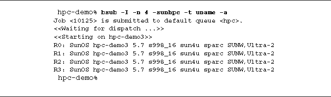

Use the -t argument to cause all output to be tagged with its MPI rank.
The -t argument cannot be used when output is redirected by the -e or -o options to -sunhpc.
For example, the following adds a rank-indicator prefix to each line of output.
