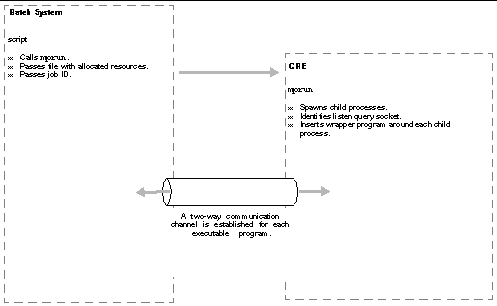

The Sun CRE environment continues to perform most of its normal parallel-processing actions, but its child processes do not fork any executable programs. Instead, each child process identifies a communications channel (specifically, a listen query socket) through which it can be monitored by the Sun CRE environment while running in the batch system.
Before releasing its child processes to the batch system, the Sun CRE environment inserts around it a wrapper that identifies its listen query socket. That wrapper program keeps the executable programs fully connected to the Sun CRE environment while they are running. And the Sun CRE environment can clean up when a socket closes because a program has stopped running.

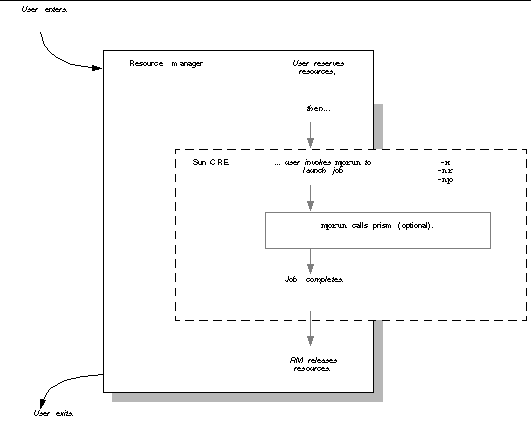

1. The job can be launched either interactively or through a script. Instructions for both are provided in the Sun HPC ClusterTools Software User's Guide and the following manpages:
2. Users enter the batch processing environment before launching jobs with mprun.
3. Users reserve resources for the parallel job and set other job control parameters from within their resource manager.
4. Users invoke the mprun command with the applicable resource manager flags. Those flags are described in the Sun HPC ClusterTools Software User's Guide and the mprun(1) manpage.
Here is a diagram that summarizes the user interaction:
