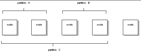

You can define multiple partitions within a cluster.
Partitions do not have to include every node in the cluster. Nodes that are not included in any partition are called independent or free-floating nodes.
A single node can be included in more than one partition. However, two partitions with overlapping nodes cannot run jobs simultaneously. And only one of them can be enabled at a time. In the example above, partitions A and B can run jobs simultaneously with each other, but not with partition C.
A job can run only on a partition that has been enabled. Normally, the system administrator who manages the cluster enables and disables partitions (for more information, see the Sun HPC ClusterTools Software Administrator's Guide).

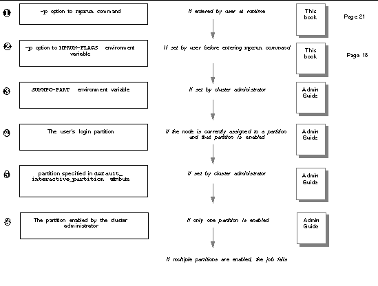

To find out which partitions are currently enabled, use the -P option to the mpinfo command, as described in How to Display Information About All Partitions (-P).
If only one partition is enabled, all jobs must run on that partition. If multiple partitions are enabled, where your particular job runs depends upon which environment variables the cluster administrator set and which options to the mprun command you entered. To determine the partition, CRE steps through the criteria shown in FIGURE 2-1, in order.

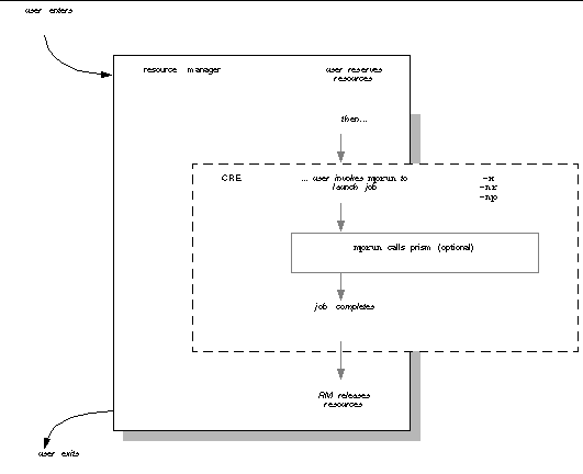

As described in Chapter 1, the ClusterTools 5 environment provides close integration between CRE and three different DRM systems:
The integration process is similar for all three, with some individual differences. The DRM system, whether SGE, LSF, or PBS, launches the job through a script. The script calls mprun, and passes it a host file of the resources that have been allocated for the job, plus the job ID assigned by the DRM system.
The CRE environment continues to perform most of its normal parallel-processing actions, but its child processes do not fork any executable programs. Instead, each child process identifies a communications channel (specifically, a listen query socket) through which it can be monitored by the CRE environment while running in the DRM system.
You can also invoke a similar process interactively, without a script. Instructions for script-based and interactive job launching are provided in Chapter 5.
The exact instructions vary from one resource manager to another, and are affected by CRE's configuration, but they all follow these general guidelines:
1. You can launch the job either interactively or through a script. Instructions for both are provided in Chapter 5 and the following man pages:
2. Enter the DRM processing environment before launching jobs with mprun.
3. Reserve resources for the parallel job and set other job control parameters from within their resource manager.
4. Invoke the mprun command with the applicable resource manager flags. Those flags are described in Chapter 5 and the mprun(1) manpage.
Here is a diagram that summarizes the user interaction:
