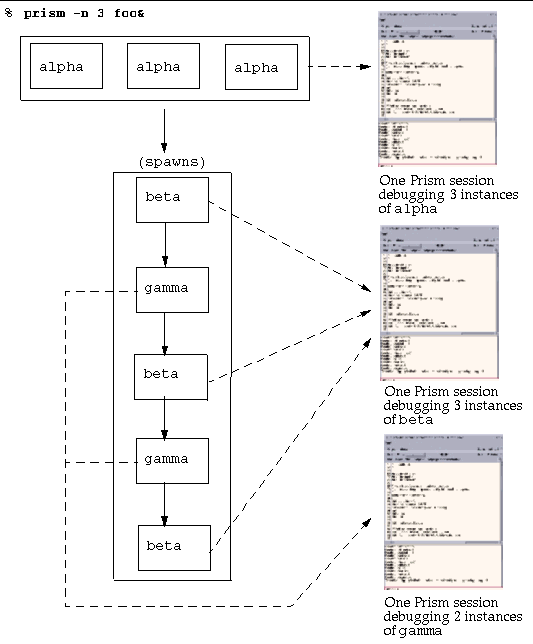

If the program to be debugged includes calls to either MPI_Comm_spawn() or MPI_Comm_spawn_multiple(), you need to set the follow_spawn Prism environment variable to on before the program reaches the first spawn function call. Otherwise, the Prism environment cannot create a new debug session to handle the spawned processes. You can set this environment variable by entering the following in the Prism command window.
(prism all) set follow_spawn = on
When follow_spawn is set to on and a spawn function call occurs, the Prism environment creates one or more secondary debug sessions, depending on the following circumstances:
Like the primary Prism processes, each secondary Prism process is located on the same node as the spawned MPI process to which it is attached.
Some Prism commands that are issued in a primary Prism debug session affects secondary Prism sessions. Others do not. For information about which commands cross primary/secondary Prism session boundaries, see Prism Commands With Special Functions in Spawned Sessions.
Also, secondary Prism sessions may not acquire every Prism option that is specified in the primary Prism session that spawned them. For a list of Prism options and their acquisition by secondary sessions, see Passing Command-Line Options to Secondary Sessions.
To disable Prism support for debugging dynamically spawned processes, set the follow_spawn environment variable to off.
Since the Prism environment creates a separate debugging session for each executable spawned by a call to MPI_Comm_spawn_multiple(), aggressive use of this function could lead to hundreds of Prism debug windows being opened. This could seriously complicate the task of tracking all the processes being debugged.
You can avoid this problem by limiting the creation of secondary debug sessions to a subset of the spawned executables. To do this, set the debug_spawn_aout variable, listing the names of the spawned executables to be debugged. The syntax for setting the debug_spawn_aout variable is
(prism all) set debug_spawn_aout = "aout_list"
For example, if a call to MPI_Comm_spawn_multiple() in the program alpha spawns the executables alpha, beta, and gamma, you can limit the creation of secondary debug sessions to beta and gamma by entering the following in the Prism command line:
(prism all) set debug_spawn_aout = "beta gamma"
The primary Prism session continues to debug alpha processes and secondary Prism sessions debug beta and gamma. The executable alpha is still spawned, but the Prism primary debug session does not create a secondary debug session for it.
If you expect to use the same aout_list in multiple successive debug sessions, you can store and reuse it automatically by storing it in the optional Prism initialization file .prisminit. When this file exists, the Prism environment automatically executes the commands contained in the file when it starts up.
For example, if you add the following lines to the .prisminit file:
set follow_spawn=onset debug_spawn_aout="beta gamma" |
the next time the Prism environment starts up, it will have spawn debugging enabled, but restricted to the spawned executables beta and gamma.

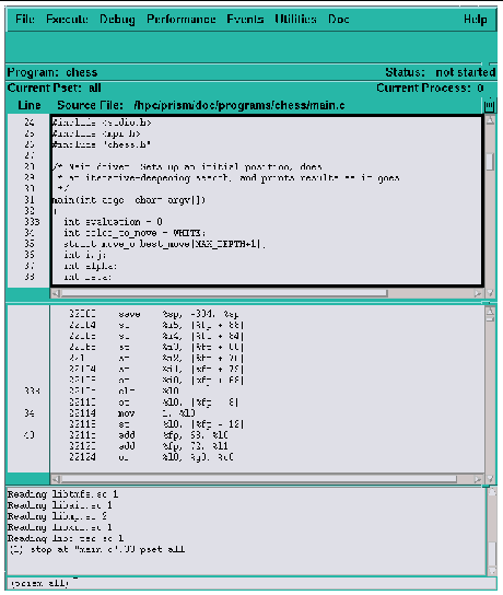

The menu bar is the line of titles across the top of the main window of the Prism environment.
Each title is associated with a pull-down menu from which you can perform actions within the Prism environment.
A keyboard accelerator is a shortcut that lets you choose a frequently used menu item without displaying its pull-down menu. Keyboard accelerators consist of the Control key plus a function key; you press both at the same time to perform the action. The keyboard accelerator for a keyboard menu selection is displayed next to the name of the selection. If nothing is displayed, there is no accelerator for that selection.
The keyboard accelerators (on a Sun keyboard) are listed in TABLE 2-4.
The source window displays the source code for the executable program loaded into the Prism environment. (Chapter 3 describes how to load a program into the Prism environment and how to display the different source files that make up the program.) When you execute the program and execution then stops for any reason, the source window updates to show the code being executed at the stopping place. The Source File field at the top of the source window lists the name of the file displayed in the window.
You can resize the source window by dragging the small resize box at the lower right of the window. If you change the window's size, the new size is saved when you leave the Prism environment.
You cannot edit the source code displayed in the source window. This must be done within an editor, which can be called up from within the Prism environment. See Chapter 6 for instructions on editing programs.
You can move through a source file displayed in the source window by using the scroll bar on the right side of the window. You can also use the up and down arrow keys to scroll a line at a time, or press the Control key along with the arrow key to move half a page at a time.
To return to the current execution point, type Control-X in the source window.
The /regexp command searches forward in the file for the string (or regular expression) that you specify and repositions the file at the first occurrence it finds. The ?regexp command searches for the string (or regular expression) in the reverse direction.

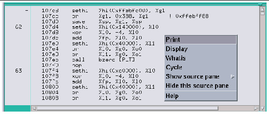

Right-click in the source window to display a menu that includes actions to perform on the selected text, as shown in FIGURE 2-2. For example, select Print to display a visualizer containing the value(s) of the selected variable or expression at the current point of execution. See Chapter 5 for a discussion of visualizers and printing. To close the pop-up menu, right-click anywhere else in the main window.
You can display the definition of a function by pressing the Shift key while selecting the name of the function in the source window. This is equivalent to choosing the Func selection from the File menu and selecting the name of the function from the list. When selecting the function name, highlight only the name, not arguments to the function.
You can split the source window to simultaneously display the source code and assembly code of the loaded program.
1. Load the program of interest.
2. Right-click in the source window to display the pop-up menu.
3. Click on the Show source pane selection in the pop-up menu.
4. Choose the Show .s source selection from the menu.
This causes the assembly code for your program to be displayed in the bottom pane of the window, as shown in FIGURE 2-3.
1. Right-click in the pane you want to close.
2. Choose Hide this source pane from the pop-up menu.

The command window is the area at the bottom of the main window in which you type commands and receive Prism output.
The command window consists of two boxes: the command line at the bottom and the history region above it. FIGURE 2-5 shows a command window.
You can resize the command window and scroll through it independently of the main window. If you do not intend to issue commands in the command window, you might want to make this window smaller so that you can display more code in the source window. If you use the command window frequently, you might want to make it bigger. If you change the size of the window, the new size is saved when you leave the Prism environment.
You can type in the command-line box whenever it is highlighted and an I-shaped cursor, called an I-beam, appears in it. See TABLE 2-3 for a list of keystrokes you can use in editing the command line. Press Return to issue the command. Type Control-C to interrupt execution of a command (or choose the Interrupt selection from the Execute menu).

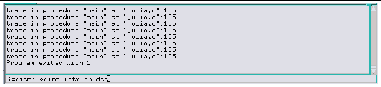

During long-running commands (for example, when you have issued the run command to start a program executing), you may still be able to execute other commands. If you issue a command that requires that the current command complete execution, you receive a warning message and the Prism environment waits for the command to complete.
Commands that you issue on the command line are echoed in the history region, above the command line. The Prism environment's response appears beneath the echoed command. The Prism environment also displays other messages in this area, as well as command output that you specify to go to the command window. Use the scroll bar at the right of this box to move through the display.
(prism all) set $history = value
This limits the maximum number of lines in the history buffer to 2000. The default is 10,000.
The Prism environment uses memory in maintaining a large history region. A smaller history region, therefore, may improve performance and reduce the chances of the Prism environment running out of memory.

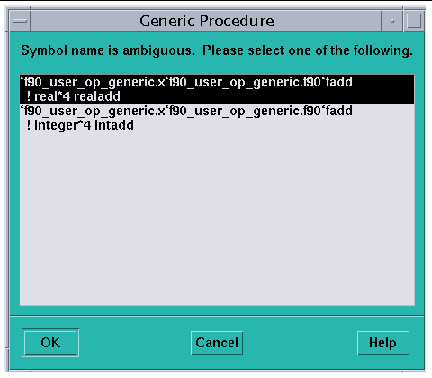

You can use Fortran 90 generic procedures in any Prism command or dialog box that asks for a procedure. If you do so, the Prism environment prompts you for the name(s) of the specific procedure(s) you want to use.
For example, you use the syntax stop in procedure to set a breakpoint in a procedure. If you use this syntax for a generic procedure in the Prism graphical interface, a dialog box like the one shown in FIGURE 2-6 is displayed.
The commands-only interface of the Prism environment prompts you in a similar fashion, as shown below:
If you choose 0 or press Return, the command is cancelled. If you choose another number, the Prism environment sets the breakpoint(s) in the specified procedure(s). For example, the following sets the breakpoint in the fadd procedure that uses real*4 data.

Issuing a kill command in the primary Prism session also kills all of the secondary Prism sessions.
1. Perform one of the following:
If you have created subprocesses, such as Solaris shells, while in the Prism environment, the Prism environment displays a message before exiting. For example, see FIGURE 2-7:
2. Take one of the following actions:
Issuing the quit command without any options quits only the session in which it is invoked.
To quit all Prism sessions--in primary and secondary sessions--use quit -all in the primary Prism session.
