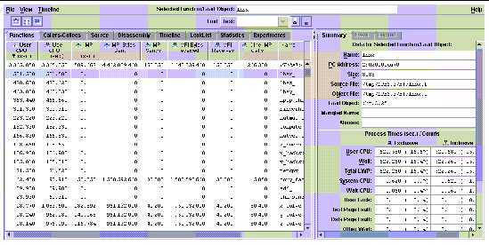

FIGURE 9-1 shows the Performance Analyzer's first view of the resulting profiling data. This default view shows how time is spent in different functions. Both exclusive and inclusive user CPU times are shown for each function, excluding and including, respectively, time spent in any functions it calls. The top line shows that a total of 3362.710 seconds, over all 25 processes, are profiled.
We see that the functions LHSX(), LHSY(), and LHSZ() account for
523.410+467.960+444.350=1435.72 seconds of that time.

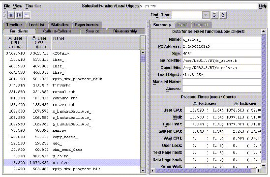

In FIGURE 9-2, we see how this overview appears when MPI tracing is turned on with the Collector's -m on switch. Note that accounting for bytes sent and received is slightly different from the way accounting is handled by MPProf. In particular, for bytes received, the size of the receive buffer is used rather than the actual number of bytes received. For more information on how bytes are counted for MPI calls, refer to the Performance Analyzer documentation volume Program Performance Analysis Tools.

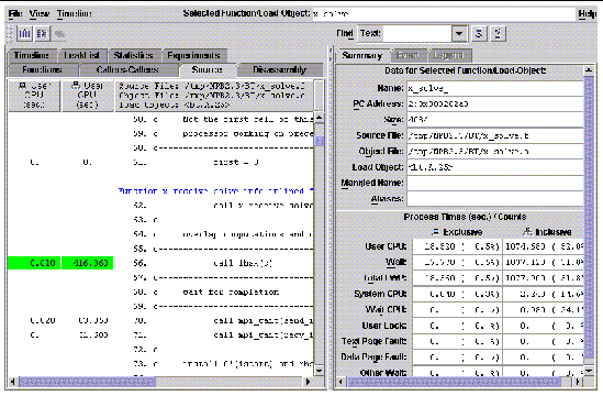

We can see how time is spent within a subroutine if the code was compiled and linked with the -g switch. This switch introduces minimal impact on optimization and parallelization, and it can be employed rather freely by performance-oriented users. When we click on the Source tab, the Performance Analyzer brings up a text editor for the highlighted function. The choice of text editor can be changed under the Options menu with the Text Editor Options selection. The displayed, annotated source code includes the selected metrics, the user source code, and compiler commentary. A small fragment is shown in FIGURE 9-3. In particular, notice that the Performance Analyzer highlights hot (time-consuming) lines of code. Only a small fragment is shown since, in practice, the annotated source can become rather wide.
To get a better idea of where time is spent at a high level in the code, you can also click on the Callers-Callees tab. FIGURE 9-4 shows a possible Callers-Callee view. The selected function appears in the middle section, its callers appear above it, and its callees below. Selected metrics are shown for all displayed functions. By clicking on callers, you can find where time incurred in the particular function occurs in the source code at a high level. By clicking on callees, you can find more detail on expensive calls a particular function might be making. This sort of analysis is probably familiar to gprof users, but the Performance Analyzer has features that go beyond some of gprof's limitations. For more information about gprof, see Using the gprof Utility.
Different metrics can be selected for the various displays by clicking on the Metrics button, as seen at the bottom of FIGURE 9-1. You can choose which metrics are shown, the order in which they are shown, and which metric should be used for sorting.

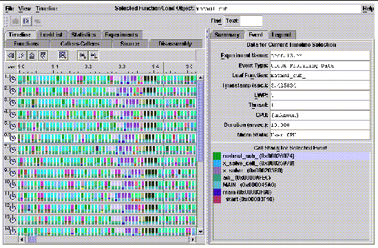

Click on the Timeline tab to see a view similar to the one shown in FIGURE 9-5. Time is shown across the horizontal axis, while experiments appear on the vertical axis. Experiments are numbered sequentially, starting from 1. For example, MPI rank 7 might appear as experiment 8. The timeline view helps you see synchronization points, load imbalances, and other performance characteristics of your parallel MPI program.

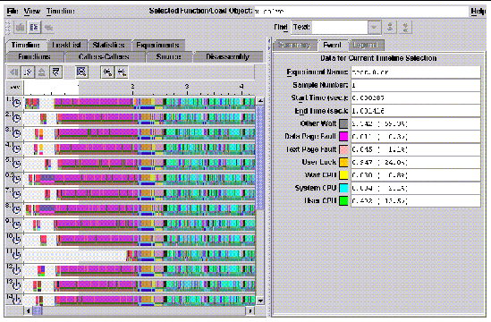

In FIGURE 9-6, another timeline view is shown. Click on an event to see its callstack in the lower right corner. When you zoom in to the time scale of the clock sampling (10 milliseconds by default), clock-sampled events appear discretely on the view. Using MPI tracing helps maintain resolution even to the highest levels of zoom.
Because clocks on different nodes of a cluster are not guaranteed to be synchronized, and because the Performance Analyzer makes no attempt to synchronize time stamps from different nodes, timeline views of Sun MPI runs that were distributed over multiple nodes in a cluster are not guaranteed to be displayed properly.

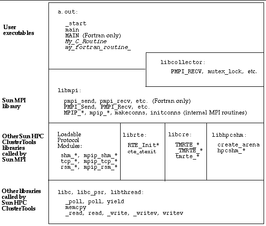

In a profile, you will typically find many unfamiliar functions that do not appear explicitly in your code. Further, it can happen that none of the familiar MPI calls you do use will appear, such as MPI_Isend(), MPI_Irecv(), MPI_Wait(), or MPI_Waitall().
FIGURE 9-7 shows examples of functions you might find in your profiles, along with explanations of what you are seeing. The functions are organized by load object, such as an executable (here, a.out) or a dynamic library.
