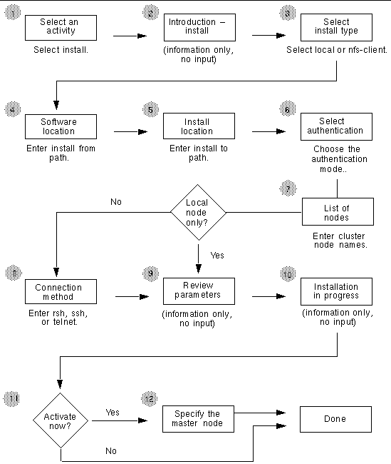

1. Read the Overview text and click on the Next button to display the Select an Activity panel.
FIGURE 3-1 illustrates the sequence of ctgui panels for the Install activity, beginning with the Select an Activity panel.
2. Select Install and click on the Next button.
This begins a sequence of installation-related GUI panels, some of which request information about the installation to be performed.
FIGURE 3-1 Sequence of ctgui Panels for Installing Sun HPC ClusterTools Software
Figure depicting the sequence of ctgui panels for installing Sun HPC ClusterTools software
3. Select the installation type - either local or nfs-client - and click on the Next button.
If you select local, the full set of Sun HPC ClusterTools software packages will be installed. If you select nfs-client, only the root packages will be installed.
4. Specify the location of the software to be installed. To install from the default location, simply click on the Next button.
5. Specify the location where you want the software to reside. To use the default location, /opt, click on the Next button.
6. Specify the cluster nodes on which the installation is to take place, using one of the following methods:
When you are satisfied with the list of target nodes, click the Next button.
7. Specify the authentication mode you want to use. Choose one of the following options:
When you have selected the desired authentication method, click the Next button.
8. If you specified only the local node in Step 6, skip this step. Otherwise, specify one of the following connection methods:
9. Review the values you have specified for the installation.
If you want to change any values, use the Back button to step through the previous panels until you are at the panel where you specified the value and make the desired change. Then use the Next button to return by steps to this panel.
When you are satisfied with the parameter values, click the Finish button to start the installation.
10. An Installation in Progress... panel will be displayed while the software is being installed.
Several forms of status information are provided on this panel:
You can also view the installation logs for each of the nodes.
When you are satisfied with the installation status, click the Next button, which causes the Is It Time to Activate panel to be displayed.
11. Click the Activate Now button to make the software ready for immediate use or click the Activate Later button to postpone the activation step to another time.
12. If you choose Activate Now, you will be asked to name the master node for the cluster.
This is one node in the cluster where the Sun CRE master daemons will run.
This completes the installation process on the cluster nodes. The next possibilities are:
If you are installing in an NFS cluster configuration and you have not yet set up and installed on the NFS server, go to Chapter 5 for instructions.
