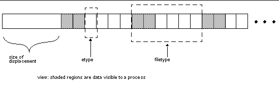

The following terms are used to describe partitioning data among processes. FIGURE 4-1 illustrates some of these concepts.
FIGURE 4-1 Displacement, the Elementary Data Type, the File Type, and the View
Graphic image showing displacement, the elementary data type, the file type, and the view.
