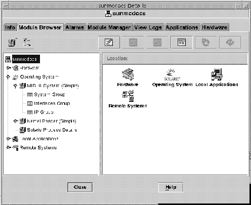

Chapter 6 Viewing Detailed Information About a Managed Object
The Sun Management Center Details window provides detailed information about a selected object. The following subjects are described in this chapter:
Overview of the Details Window
The details view is a subset of the Domain view. The highest hierarchical object in a details view is the host machine or module object. For more information on module objects, see To Create a Module Object. Unlike the administrative domain view, the details view enables you to see modules and the various monitored properties and statistics contained in the modules.
The Details window displays several tabs. The commonly seen tabs are shown in Table 6–1.
Click a tab to view the named information.
The tabs that appear in the Details window depend on the type of selected object. For example, the Hardware tab appears only if the Config-Reader module is supported on your system. For additional information on the tabs for your specific hardware object, see your platform supplement.

Info
Provides general information about the managed object including name, IP address, polling type, and so on. This information is collected at the time the object is created. Info is the default view if the managed object is being monitored through SNMP or ICMP or if the object is in a non-monitored status.
Module Browser
Enables you to navigate through the hierarchy and contents views of the hardware, operating system, local applications, and remote systems. Module Browser is the default view if the managed object is being monitored through a Sun Management Center agent.
The Module Browser is described in Chapter 7, Browsing Information About a Managed Object.

Module Browser Tab
The Module Browser tab displays the hierarchy and contents views for managed objects that are monitored through Sun Management Center agents. These objects represent hardware, operating system, local applications, and remote systems.
See Chapter 7, Browsing Information About a Managed Object for detailed information on using the Module Browser tab.

    The Details window appears, as illustrated in the following figure.
    Figure 6–8 Details Window for a Selected Object
    Details window shows modules for host sunmcdocs.
