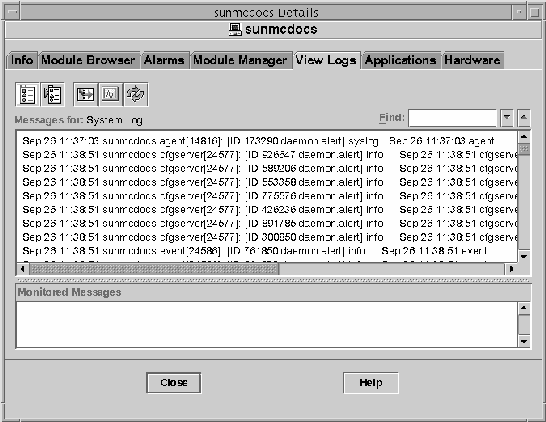

The View Logs tab enables you to view several types of messages:
By default, only the system log messages in /var/adm are displayed. File names for these system log messages start with the word messages.
If you select the Sun Management Center Log option on the Log File menu, a list of log file choices is displayed. An example is shown in Figure 6–11.
As shown in Figure 6–1, the View Logs window has two scrollable panes: Messages For and Monitored Messages.
Figure 6–1 View Logs Screen
View Logs window shows messages for the System Log file.
Note –
If no messages match the Filter criteria, the following message appears at the bottom of the View Logs window.
No matches found for this log file
