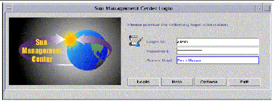

The Sun Management Center Login dialog box is displayed (FIGURE 3-1).
2. Log into Sun Management Center.
You must supply the following information:
The Sun Management Center main console window is displayed (FIGURE 3-2).

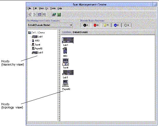

1. Locate the host you want to test in the Sun Management Center main window (FIGURE 3-2).
If you cannot locate the host, consider the following:
Refer to the Sun Management Center 3.5 User's Guide for further details.
2. Select the host for testing in one of the following ways:
The Details window for the selected host is displayed (FIGURE 3-3).

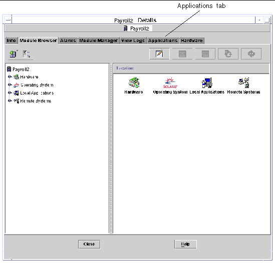

3. Click the Applications tab to access the Sun Management Center add-on products (see FIGURE 3-3).

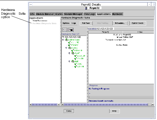

4. Click the Hardware Diagnostic Suite option from the list of Applications in the left panel (see FIGURE 3-4).
The Hardware Diagnostic Suite console window is displayed.
Note - The Hardware Diagnostic Suite agent starts automatically when you select the Applications tab. |
