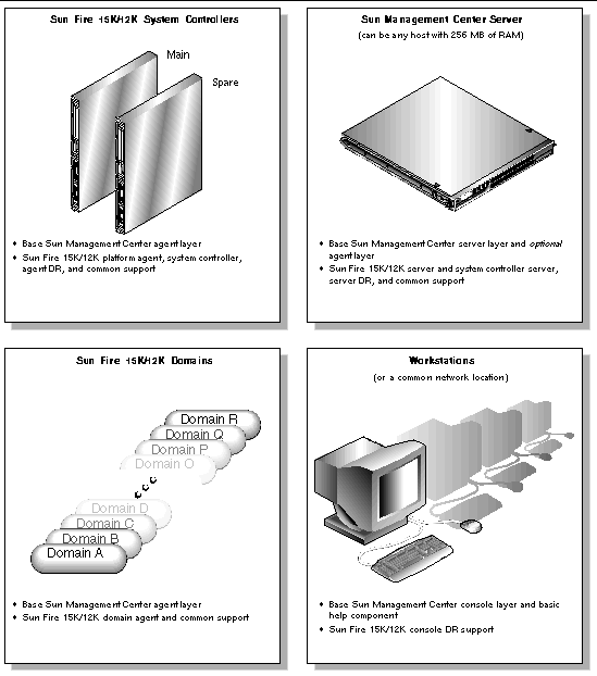

The Sun Management Center software is divided into:
Sun Fire 15K/12K support requires the Sun Management Center 3.5 base packages and the add-on Sun Fire 15K/12K packages. The Sun Management Center 3.5 Installation and Configuration Guide describes basic information about installing and setting up the Sun Management Center 3.5 base packages and starting and stopping the software. This chapter describes the processes specifically related to the Sun Fire 15K/12K systems.
Caution - Use the installation scripts and the setup scripts provided with the Sun Management Center 3.5 software. Do not manually add packages or manually change configuration files. |
Your Sun Management Center 3.5 installation and setup scripts or GUI panels may not display exactly the same messages in exactly the same sequence as the examples shown in this chapter. However, these examples show the basic messages you will receive in approximately the sequence you will receive them. Your actual installation and setup scripts depend on the add-on components you choose to install and other choices you make.
The Sun Fire 15K/12K system-specific packages received with the Sun Management Center 3.5 basic functionality, and the minimum size required for installation in kilobytes (KB) are listed in TABLE 2-1. Refer to the Sun Management Center 3.5 Installation and Configuration Guide for information about general Sun Management Center prerequisites, including minimum disk space requirements.

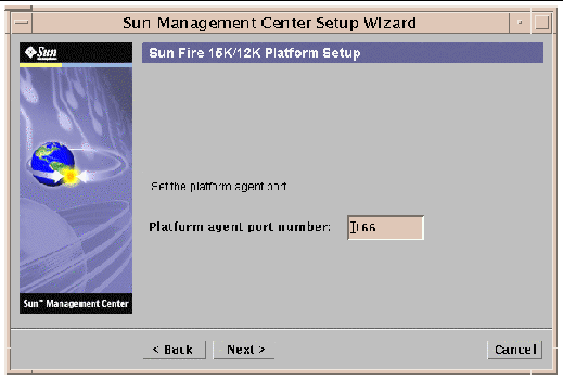

The system displays the message.
Please enter any port [ 1100 to 65535 ] : |

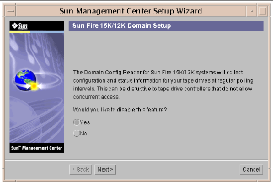

7. Type y to set up the Sun Fire 15K/12K domain now. Type n to not set up the Sun Fire 15K/12K domain now.
Either way, the system displays this message.

The system displays this message.

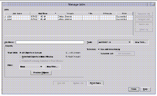

2. From your main Sun Management Center console window, select the Manage Jobs... option from the Tools menu.
The system displays the Manage Jobs panel (FIGURE 2-2), which allows you to distribute the Image File.

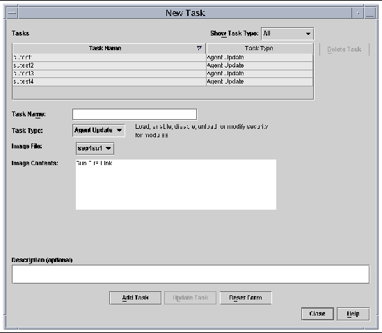

3. In the Manage Jobs panel, select the New Task... button.
The system displays the New Task panel (FIGURE 2-3), which allows you to specify the Agent Update Image File to distribute.
4. In the New Task panel (FIGURE 2-3), do the following:
a. Select Agent Update for the Task Type.
b. Select the Image File you created in Step 1.
5. In the Manage Jobs panel (FIGURE 2-2), do the following:
b. Select the Task you created in Step 4.
c. Do one of the following to schedule when you want the Task to run.
d. Do one of the following to select the objects (agent machines) to which you want to distribute the Image File.
e. Preview the objects (agent machines) you have selected and redo your selections if necessary.
The job starts and distributes the Image File to the objects (agent machines) you selected. When the job is running, it appears in the Job list of the Manage Jobs panel. The panel shows the status of the job when running and when complete.

The Sun Fire 15K/12K Platform Setup panel displays the following.
Checking configuration files... Status: Set the platform server: <SChostname> Checking for default platform agent port... Checking of configuration files complete. |
If the default platform port was not set previously, the Sun Fire 15K/12K Platform Setup panel displays the following.
The default port for the Sun Management Center platform agent is 166 Would you like to use the default Sun Management Center platform agent port? O Yes O No |
The Sun Fire 15K/12K Platform Setup panel confirms the port number that you chose.
Confirmation of the platform agent port. Platform agent port: 166 |
If you have added or changed the port number, the Sun Fire 15K/12K Platform Setup panel displays this message.

1. On a Sun Fire 15K/2K domain, type es-guisetup to start the Sun Management Center 3.5 Setup Wizard.
Once the Sun Management Center base software setup is complete, the Select Add-on Products panel appears with a list of add-on products by platform installed on your system. In this example, Sun Fire 15/12K Monitoring is the product and platform.
The following add-on products are newly installed on this system and will be set up. - Sun Fire 15K/12K Monitoring |
2. Click Next to start the Domain Setup.
The Sun Fire 15K/12K Domain Setup panel displays the following:
if your tape drive controllers do not allow concurrent access, you will want to disable this feature.
The Sun Fire 15K/12K Domain Setup panel displays the status of updating configuration files.
Updating configuration files... Status .... .... Update of configuration files complete. |
The Sun Fire 15K/12K Domain Setup panel displays this message.
Sun Fire 15K/12K domain setup is complete. |
