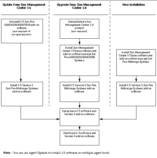

FIGURE 2-1 shows the high-level details of the installation process.
If you are updating existing Sun Management Center 3.5 add-on software for Sun Fire Midrange Systems, you need to:
Note - Before you start, be aware that you can use Agent Update to install Sun Management Center 3.5 software on multiple agent hosts. For instructions about updating multiple hosts using agent update, see Updating Multiple Hosts Using Agent Update. |
See the following references depending on whether you are installing and setting up using the CLI or GUI:
Refer to Chapter 5 of the Sun Management Center 3.5 Installation and Configuration Guide for detailed information about upgrading from Sun Management Center 3.0 software.
This section summarizes new installation and setup procedures for Sun Management Center 3.5 software on Sun Fire Midrange Systems:
For a new installation for this release:

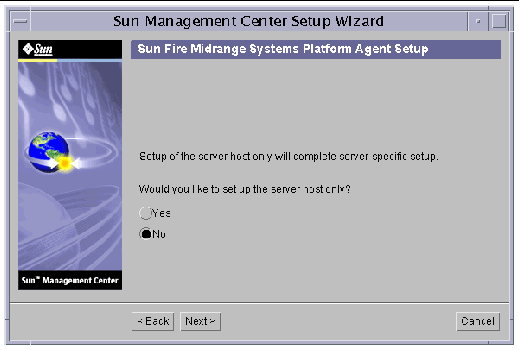

Set up the Sun Fire Midrange Systems Platform Agent on any machine where you have installed it.

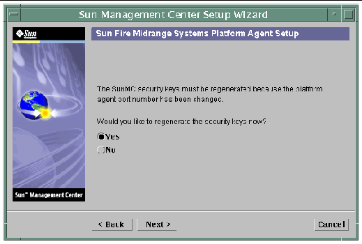

1. Type es-guisetup on a machine where the platform agent is installed to start the Sun Management Center Setup Wizard.
Once the Sun Management Center base software setup is complete, the Wizard displays the following message:
Select Add-on Products The following add-on products are newly installed on this system and will be set up. - Sun Fire Platform Administration |

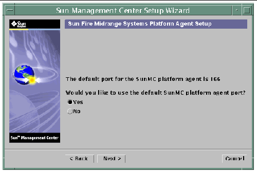

The Sun Fire Midrange Systems Platform Agent Setup panel displays the following message. Go to Step 22.
The Sun Fire Midrange Systems Platform Agent Setup panel displays this message:
The Sun Fire Midrange Systems Platform Agent Setup panel displays the following:

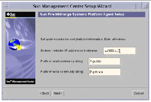

6. Enter a value for each prompt (required):
a. Type the host name or IP address of the System Controller (for example, 10.8.28.209).
Caution - If you want to use the SC failover feature, you must put a logical IP address in this field. Both SCs can then use this logical IP address. Only one SC can use a physical IP address. If you do not put a logical IP address in this field and if a SC failover occurs, you receive a red alarm that the SC is not responding. For information about enabling SC failover and setting up a logical IP address, see To Enable the SC Failover Capability and Set Up a Logical IP Address. |
b. Type the read community string for the platform (for example, P-public).
c. Type the write community string for the platform (for example, P-private).

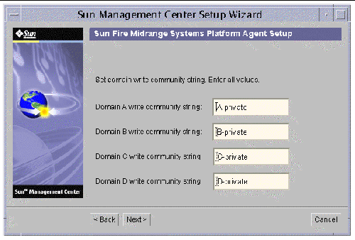

The Sun Fire Midrange Systems Platform Agent Setup panel displays the following message:
a. Type the write community string for domain A, such as A-private
b. Type the write community string for domain B, such as B-private
c. Type the write community string for domain C, such as C-private
d. Type the write community string for domain D, such as D-private

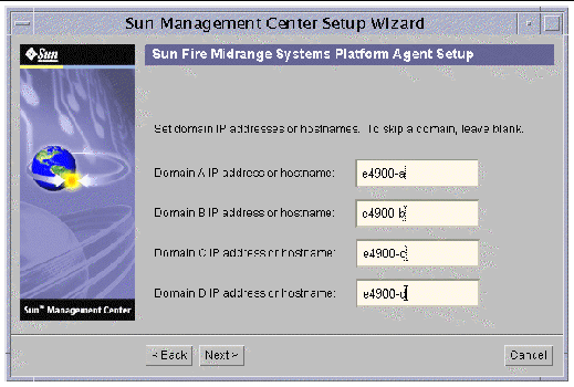

a. Type the IP address or host name of domain A, or leave blank.
b. Type the IP address or host name of domain B, or leave blank.
c. Type the IP address or host name of domain C, or leave blank.
d. Type the IP address or host name of domain D, or leave blank.

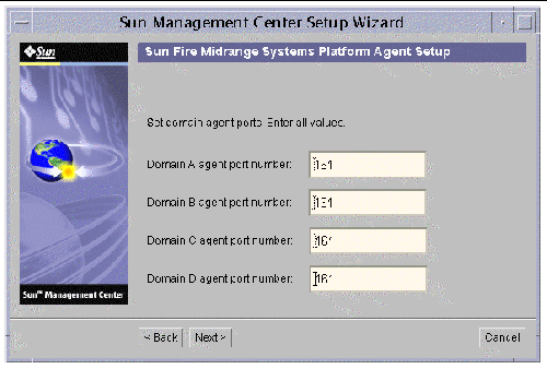

a. Type the Sun Management Center agent port number on domain A.
b. Type the Sun Management Center agent port number on domain B.
c. Type the Sun Management Center agent port number on domain C.
d. Type the Sun Management Center agent port number on domain D.

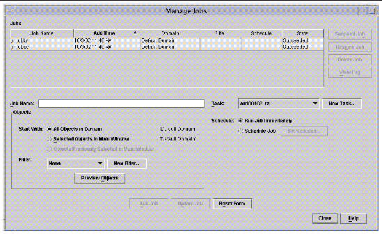

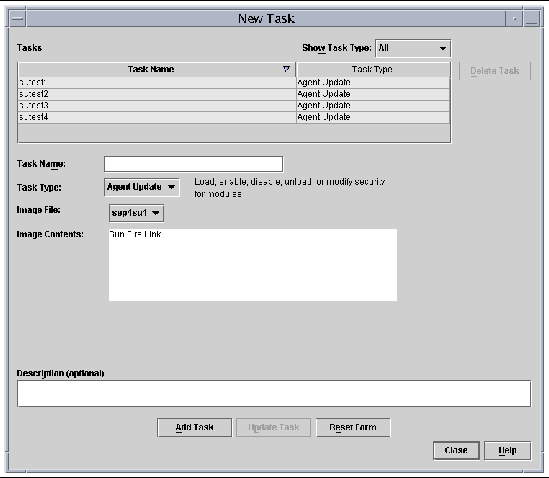

This section describes how to update multiple hosts at once using Agent Update. The Agent Update process itself must be run on the Sun Management Center server machine. You also need to ensure that Sun Management Center 3.5 agents are running on all the target hosts.
To use Agent Update to fully install and set up the Sun Fire Midrange Systems Platform Administration module, you must create an Agent Update configuration file for the module on the target hosts, before you run the Agent Update Process on the Sun Management Center server machine.

2. From your main Sun Management Center console window, select the Manage Jobs... option from the Tools menu.
The system displays the Manage Jobs panel (see FIGURE 2-9), which allows you to distribute the Image File.
3. In the Manage Jobs panel, select the New Task... button.
The system displays the New Task panel (see FIGURE 2-10), which allows you to specify the Agent Update Image File to distribute.
4. In the New Task panel (FIGURE 2-10), do the following:
a. Select Agent Update for the Task Type.
b. Select the Image File you created in Step 1.
5. In the Manage Jobs panel (FIGURE 2-9), do the following:
b. Select the Task you created in Step 4.
c. Do one of the following to schedule when you want the Task to run:
d. Do one of the following to select the objects (agent machines) to which you want to distribute the Image File:
e. Preview the objects (agent machines) you have selected and redo your selections if necessary.
The job starts and distributes the Image File to the objects (agent machines) you selected. When the job is running, it appears in the Job list of the Manage Jobs panel. The panel shows the status of the job when running and when complete.

This script asks for the port number for the new platform agent and the security seed. If you used a seed other than the default when setting up the Sun Management Center server, provide the same seed for this agent.
4. To set up this instance, go the Step 3 in the following procedure To Set Up a Sun Fire Midrange Systems Platform Administration Module for a New Platform Agent Instance
1. Become superuser by using the su command.
2. Go to the directory where Sun Management Center software is installed.
For example, if Sun Management Center software is installed in /opt/SUNWsymon, go to the directory /opt/SUNWsymon/sbin.
3. Run the es-platform script:
where instanceName is the name of a new platform agent instance.
This script asks for the port number for the new platform agent.
a. Enter a new, not previously used port number.
Note - Be sure you use this port number when you set up this instance and when you create this platform instance object on the Sun Management Center console. |
The script asks for the security seed.
b. If you used a seed other than the default when setting up the Sun Management Center server, provide the same seed for this agent.
4. Stop the Sun Management Center agent process.
5. To set up this instance, go the Step 3 in the following procedure To Set Up a Sun Fire Midrange Systems Platform Administration Module for a New Platform Agent Instance.

The es-setup.sh script asks for this information:
This script can be run again to change the information provided in the previous setup.
