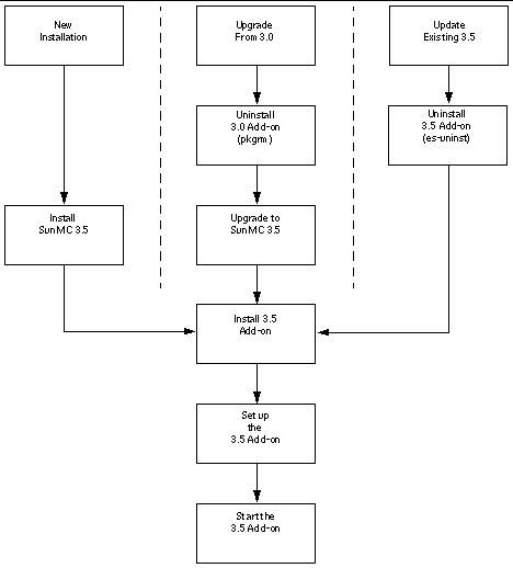

Installation Summary
1. If necessary, uninstall any Sun Management Center 3.0 add-on software on the Sun Management Center server and agent.
For details, refer to Removing Existing Hardware Platform Modules.
2. If necessary, upgrade the Sun Management Center software to version 3.5 on the Sun Management Center server and agent.
For further details, refer to the Sun Management Center 3.5 Installation and Configuration Guide (part no. 816-2678).
3. If necessary, uninstall any pre-existing version 3.5 of the add-on software on the Sun Management Center server and agent.
For details, see Removing Existing Hardware Platform Modules.
4. If necessary, install Sun Management Center 3.5 software on the system used as the Sun Management Center console.
For details, refer to the Sun Management Center 3.5 Installation and Configuration Guide (part no. 816-2678).
5. Install Sun Management Center 3.5 server software and the add-on server software on the Sun Management Center server.
For details of how to install core Sun Management Center 3.5 server software, refer to the Sun Management Center 3.5 Installation and Configuration Guide.
For details of how to install the add-on server software, see To Install the Sun Management Center Server Software.
6. Install Sun Management Center 3.5 agent software and the add-on agent software on the platform(s) to be monitored.
For details of how to install core Sun Management Center 3.5 agent software, refer to the Sun Management Center 3.5 Installation and Configuration Guide
For details of how to install the add-on agent software, see To Install and Setup the Sun Management Center Agent Component.
See FIGURE 2-1 for high-level details of the installation process.
FIGURE 2-1 Installation Process Flow
