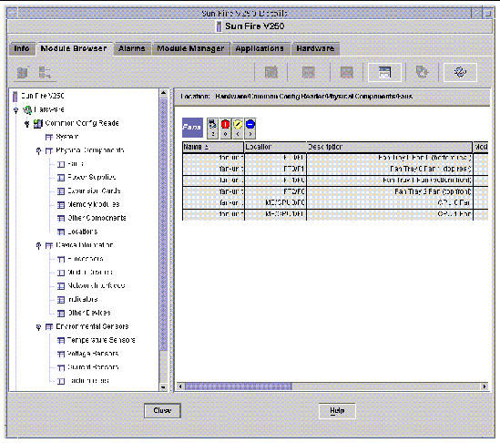

Physical Component Properties
The tables in this section represent instances of physical components within the system.
Common Properties
All physical components (apart from the Locations table) share a common set of properties:
- Name
- Location
- Description
- Model Name
- Operational Status
- Additional Information
- Part Number
- Version
- Serial Number
- Manufacturer
- Hot Swappable
- Removable
FIGURE 3-1 Physical Components Showing Location and Description Columns (Sun Fire V250 Shown)

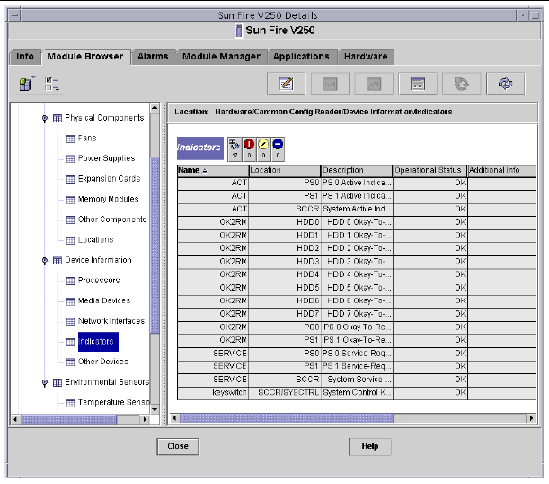

Logical Device Properties
Devices represent the logical devices. For example, a CPU module could contain one or more processors, hence the CPU module would be represented as a physical component, whereas the processors within it would be represented here as logical devices. The following tables enumerate the logical devices included in the common model.
FIGURE 3-2 Part of the Logical Device Table Showing Indicators (Sun Fire V250 Shown)
Logical devices introduce an Availability property. The Availability values are:

Indicators
TABLE 3-12 Indicator Table Properties
SunMC Property
Comments
Name
Unique name
Location
Path to the device location
Description
Informal component description
Operational Status
Current device status
Additional Info
Supporting textual information for the current Operational Status
Indicator State
STEADY, OFF, ALTERNATING or UNKNOWN
Expected State
STEADY, OFF, or ALTERNATING
Color
Indicator color
Other Devices
This table is used for all logical devices other than those already listed
TABLE 3-13 Other Device Table Properties
SunMC Property
Comments
Name
Unique name
Location
Description
Operational Status
Current component status
Additional Info
Availability
The device availability (offline, online)
Redundancy Status
Device status as part of a redundancy group
Device ID
Device path under /devices
