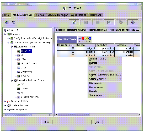

Use the dynamic reconfiguration data tables in the right half of a Details window to find the last-known state of a dynamically reconfigurable board or device.
There are two sections of tables:
An attachment point is a collective term for a board and its slot. The Attachment Points tables show information about the following types of board slots:

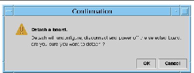

To Detach a System Board |
1. Log in as a member of the esadm group to the domain from which you want to detach a system board.
2. Right-click on the Unique Ap_Id for the system board you want to detach in the appropriate board table.
The system displays a menu of board operations.
3. Choose Detach from the menu.
The system displays the Detach confirmation box (FIGURE 8-2).
4. Left-click on the OK button to unconfigure, disconnect, and power off the chosen board. Otherwise, left-click on the Cancel button to cancel the detach operation.

1. Log in as a member of the esadm group to the domain in which you want to show status for a system board or slot.
2. Right-click on the Unique Ap_Id for the system board or slot for which you want to show status in the appropriate board table.
The system displays a menu of board or slot operations.
3. Choose Show Status from the menu.

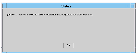

For example, if an operation fails, the status shows this type of message (FIGURE 8-6):

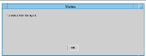

After the configure operation finishes successfully--or if no command has been executed--the status shows this message (FIGURE 8-7):
4. Left-click on the OK button when you are finished looking at the status.
