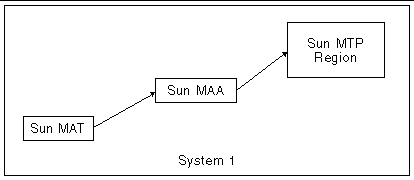

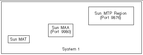

In a simple environment where one system has one region to be administered, the three components (Sun MAT, Sun MAA, and Sun MTP) are all co-located, as shown in the following figure:

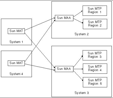

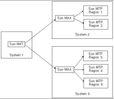

The following figure illustrates a more complex environment that has multiple regions running on multiple systems, all monitored from a single point.
It is also possible for more than one administrator to run Sun MAT concurrently and access the same regions. This is illustrated in FIGURE 12-3.

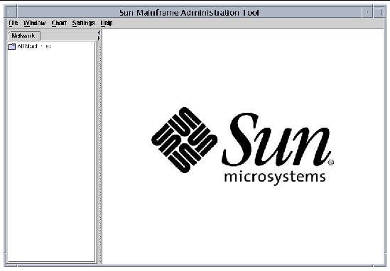

2. Execute the sunmat shell script, which is located in the Sun MAT bin directory:
The Sun MAT GUI starts. See FIGURE 12-4.

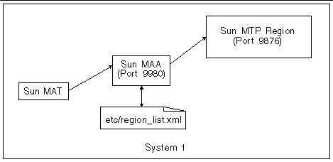

The example in this section uses a simple configuration like the one shown in the following figure. The procedure also applies to complex configurations.
In this example Sun MAT is running on the same system as Sun MAA, although it need not be. Sun MAA has been started listening on the default port of 9980.

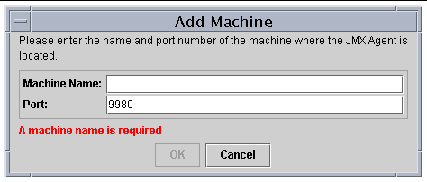

This option will make an agent known to Sun MAT. See FIGURE 12-6.
a. Type the name of the system on which the agent is running.
b. Verify the port number on which the agent is listening.

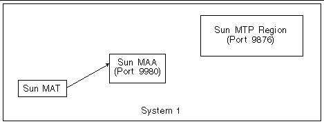

Sun MAT will contact the agent, and a machine entry will be displayed in the tree panel on the left side of the Sun MAT display.
Communication is now established between Sun MAT and Sun MAA, as shown in FIGURE 12-8.

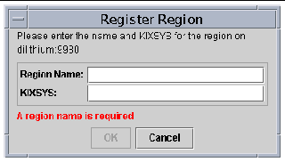

2. In the left tree pane, highlight the machine where the region you want to register is located.
3. On the menu, select File
Register Region.
a. Type the name of the region as you want it to display on the screen.
b. Type the fully qualified directory name of the region's $KIXSYS directory.
Note - The agent will determine the port number the unikixadmin daemon is listening on by accessing $KIXSYS. |
An entry representing the region will appear beneath the machine name in the left pane of the Sun MAT GUI. You can now use Sun MAT to perform administrative functions on the region.

The details about the region are stored by the agent to a local disk file (etc/region_list.xml under the Sun MAA installation directory), so that they will be available even after the agent is stopped and restarted.

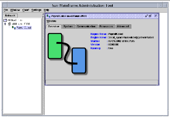

Double-click the region entry in the left pane.
FIGURE 12-12 shows the region's Overview tab.
