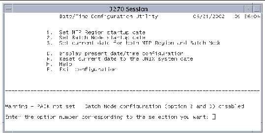

Type the following command to display the screen shown in FIGURE B-1:
[ D ]
The menu options are described in the following subsections.

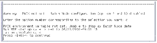

Select the Display (D) option on the Date/Time Configuration Utility menu screen.
This displays the date/time configuration and the startup time for both Sun MTP and Sun MBM systems,
If the date was set using option 3, the current date for the system, which is the specified date plus the time elapsed since the date was set, is displayed. The display indicates that the date/time is relative.
If the date was set using options 1 and 2, the startup date is displayed and indicates that it is an absolute date.
If the date/time was not configured for Sun MTP or Sun MBM, it is indicated in the display.

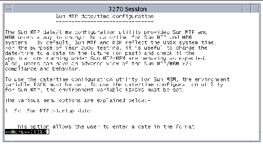

Select the Help (H) option on the Date/Time Configuration Utility menu.
This displays the help file shown in FIGURE B-4, which describes the date/time configuration utility options.
Use these keys to move around the Help screen:
Prompts you to press Enter (the Return key, not the keypad Enter key) to return to the Date/Time Configuration Utility menu. |
